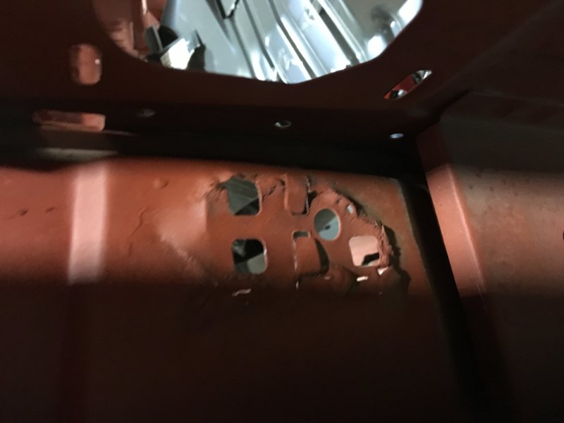

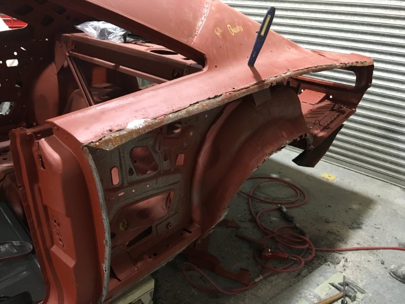

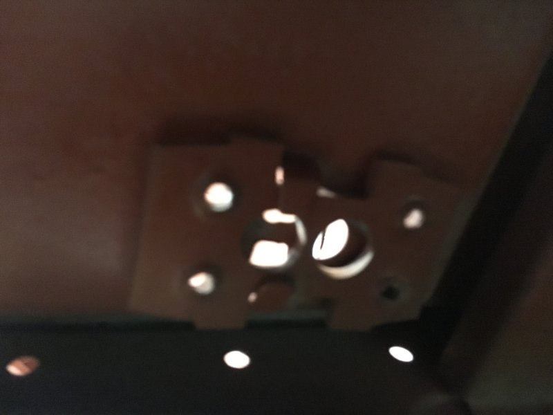

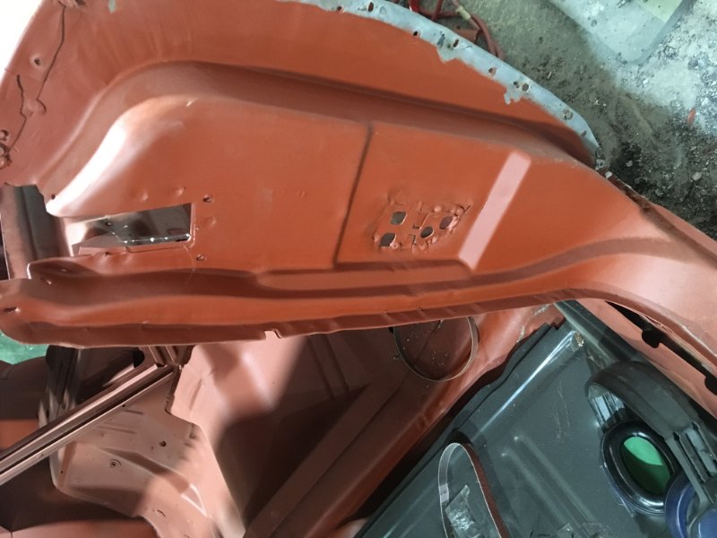

I need a little part that sits BEHIND the door strike plate for my 1970 Charger... I have one for the passenger side (so have photographed that one) - need one for the driver's side...
SEE PIX - anyone have one I could buy?
Anyone know what it is called?
Door Striker plate?? STRANGE PART NEEDED

Looks like a captive nut plate. It allows for some adjustment of the striker latch when you're trying to get the doors to fit.
If you're stuck you could probably make one. Use the other side as your template. Draw around it on a piece of card, flip it over, mark it out on a piece of apropriately thick steel, cut it out and then using the original as a reference mark, drill and tap the holes.

Agree probably quicker and cheaper to make your own, it holds a rectangular threaded plate that moves around to give some adjustment.
