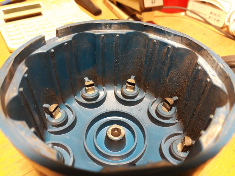

Here's a picture of the old distributor cap. I'm embarrassed it got that bad and amazed it even ran at all...……!

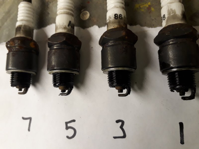

Just a quick update on the misfire. First thing was the spark plugs out. Pretty evident Cylinder 1 plug was fouled up, burnt out and not firing. Plug gaps were all less than 20thou and evident they were not getting hot enough on the Left bank. Right bank plugs were all a good colour. Changed all the plugs, gapped to 30thou (only had Champion RJ12YC on the shelf) and it started and ran fine, but retarded the ignition very slightly and it ran better. Will do proper timing light check today, but happy that it was just plugs. Will look at the electronic dizzy and better coil in the next few weeks.

yeah they are a bit grotty aren't they

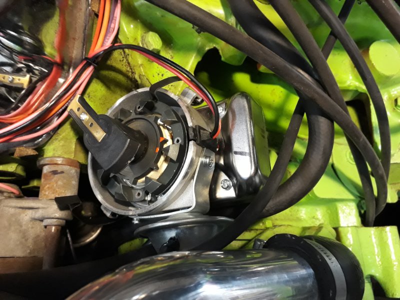

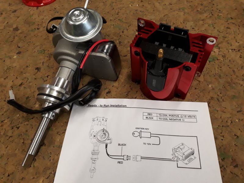

Final update / outcome. Searching on here I found another thread where someone bought / recommended a 12v coil & electronic distributor by Assault Racing. I dropped them an email, had a very quick reply pointing me to their Ebay store 'kmjperformance' and bought their packaged coil & distributor for $91 plus postage was $17 and prepaid VAT/import duty at $24.54. Distributor cap has male terminals so had to change the leads, but was going to do that anyway, so ordered a set of 8.5mm wires from Summit Racing. Swopped over the distributor, chopped out the ballast resistor and ran new 12v supply to the coil and fitted the new leads. Manually approximated the timing and it fired up. Sounds much sharper and more instant throttle response. Just got to fine tune with a timing light then back on the road this weekend. Very pleased with the kit. In the pictures you will see I marked #1 tip on the rotor in red paint plus the BTDC in the original firing position, as I then had to re-index the distributor body anticlockwise to the next firing point to allow more adjustment for advancing the timing.
- Assault Racing Distributor and huge coil - Note the extensive instructions with the distributor !!

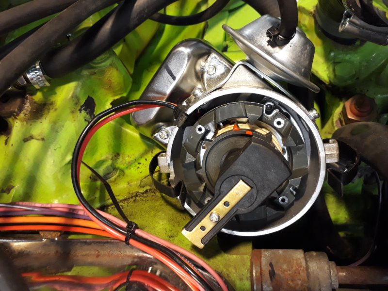

- First position of distributor, #1 & BTDC poistion marked - not enough room to advance the ignition enough as the vacuum canister fouled on the heater water pipe.
- 20190319_105011.jpg (105.14 KiB) Viewed 2537 times
- Distributor re-indexed on #1 cylinder to give more room for advancing the ignition clockwise if needs be.
- 20190319_105125.jpg (106.08 KiB) Viewed 2537 times

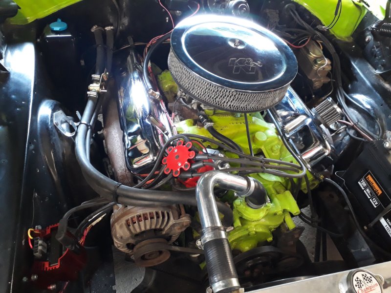

- Finally done - just got to tidy up the wiring and plug leads and job done
- 20190319_151808.jpg (112.33 KiB) Viewed 2537 times

Nice. My MSD all in one is a similar thing. 12v in one end and forget about it.
Cant get my vac advance to work at all though - blocked it off in the end. Soon as you connect it up it bangs , shudders, backfires - the works !
Good job.
