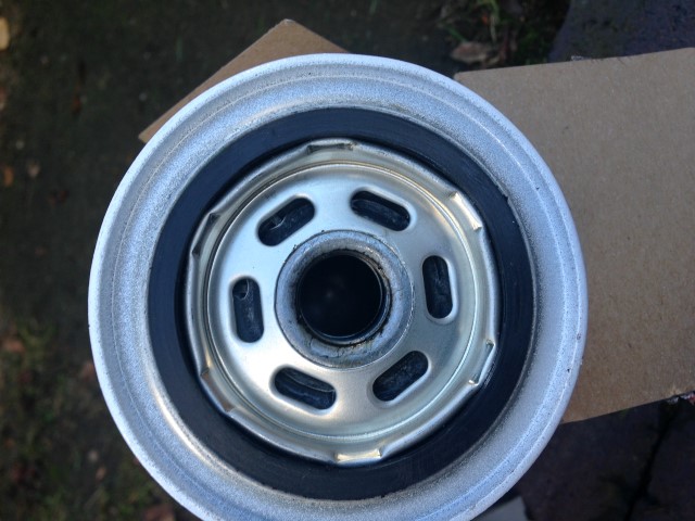

I found a nice ford one a while back
bit of chat here...
viewtopic.php?f=6&t=54204&p=599520&hilit=AFL+1#p599520
Notice seal retention which is good
hole size and method of creation NICE n BIG
the fact that the anti drian back seal actually covers the inside of those holes....
and proper metal threaded part for mounting rather than the normal punched/pressed n threaded set up on less worthy cans.
there might be an old brillo pad inside for all I know but they at least put a bit of time and effort into the rest of it
