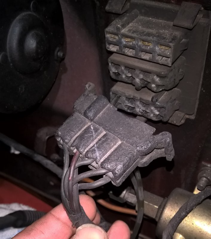

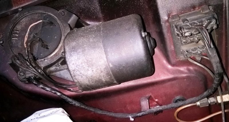

My connector and wiring got a bit frazzled in the fire, the motor seems ok though.
Anyone got a connector with or without wiring? The bulkhead side of the connector would be great too.

Have you considered bypassing the block and just hardwiring both looms together? I would, cuts out the connection completely :thumbright:

I think you need 3 durite 6 way spade connectors in male and female
the durite brand can be bolted down with tiny bolts or riveted ...see the little indents
take your current bulkhead connector
use a grinder to take off the current males
use small bolts to mount up the Durite males in place
put females on ends of wires
good as new but white
costs about 6 quid + time and a filed down electricians screw driver for pinging connector tags +lots of jam jar labels and a pen
mask off spray the lot black
nobody knows

You can keep original looking if you very carefully drill out the relative holes in the connector and run each wire through its designated hole. Bit fiddly but a decent 'last resort' if needed. Good luck with this project :thumbright:
