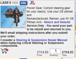

So doing some shopping and I came across this at rockauto.
Am I reading it right ? I mean yes, postage will be expensive but this suggests they rebuild your box for £100 ? Doesnt sound right to me... but given that nobody appears to have hot tips here in the UK it is making me wonder.

Re: 68 Charger steering box rebuild
I think this is a bit of a play on words...My understanding is that cores are becoming scarce (and power steering pumps) so they carry a stock of rebuilt cores from previous customers and send you the correct one as a replacement for the one you sent. Yours is then sent off in a batch to be mass reconditioned (remanufactured hence the term 'reman'). The cycle continues etc etc. I may be wrong but think that's the system.
I tried to have my power steering box rebuilt and it was never right to be honest. I took the plunge and just bought one through my local American car parts supplier who brought it in on their regular shipment. Took a week to arrive, £150 all in and been fine since. This was a while ago so not sure on prices etc. I didn't have to give them my old one but this may have changed now.
