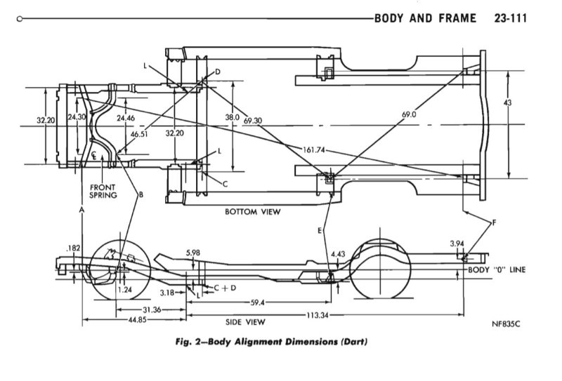

After much pain, but with support from many helpful people, I now have a roof section to allow me to restore my Chrysler Valiant from a custom 'vert back to the original hardtop.
It's not going to be a simple task! The body shop guy who is helping me with this, has asked me for measurements, against reference points on the body so he can align the roof as accurately as possible. There doesn't appear to be any original documentation with these measurements.
:help:
Is there anyone in this group with a 1969 Dodge Dart (or equivalent), who could help me by providing some measurements if I send through what I need?

Posts: 9570
Re: Valiant VF roof restoration - Dodge Dart '69->
this is all i could find
this come from here http://www.mymopar.com/index.php?pid=109
69 coronet charger dart service manual
the 67 version may be of use for comparison
but in theory if the car is on a lift, supported and is chocked/supported so that those under floor dimensions are correct and the doors open and close
i guess you are as near as damn it
dart dimensions.JPG (56.17 KiB) Viewed 3366 times

yes it would provided it is a true pillarless hard top rather than a 2 door post car i.e no metal from B pillar(door lock post) up to the roof
the post cars are a bit more sit-up and beg in styling. door shorter roof shorter different screen s front and rear and rarer
Aussie VF used 67/68 pillarless dart body on a mid - late 60s auto trans A body floor pan i.e one designed in a manner that makes a small block 727 hit the front of the tunnel/bulkhead flange unless you own a hammer i.e little tunnel
dave

Your Dart is a beauty! Where is it located?
My body guy will probably get started in a month or so once my front quarters arrive from Australia in a crate with a couple of Mad Max Falcons.
He has asked me for the dimensions of the windows. The dimensions around the window surrounds (metal to metal) would be useful but I think he will probably have to fine tune it with actual windows and rubber in place.
What would be the best way to get in touch with you to talk dimensions?
Aussie Chrysler VF Valiant "Scottish Val"

My Dart is located in SW Leicestershire. You are welcome to come and have look/measure or I can have a measure for you. But it will be difficult to measure metal to metal apertures as the glass/rubber/trim is all in place ?
