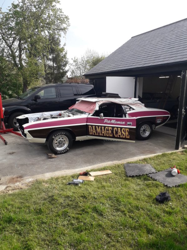

It's In in!!! (Definitely!!!)
Well, in fact it went IN, Out, In, Out, In, Out, and finally in...
Still loads to do and the clock is ticking.....
- Back in!! (2).jpg (87.96 KiB) Viewed 2187 times
- Back in!! (3).jpg (131.72 KiB) Viewed 2187 times

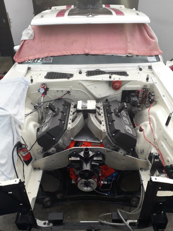

Wow. And I always feel sorry for myself with clearance irritation. Thats bonkers ! Does it have exhaust pipes ?!?!
Re: It's In in!!! (Sort of...)
Yes, Morgan; they are installed. I think they form the 3rd Ring of Dante's Inferno.
I had to make up a separate set for the dyno as these wrap around the transmission....
There is at least 3/8" Clearance between the Right Hand Rocker Box and the Shock Tower, and Challengers have one of the widest engine bays too....
You have to take the Steering Column out, the Drag Link off, the Pitman Arm off, the Torsion Bars out to get the engine in and out.....
.....plus the normal stuff such as Exhausts, Radiator, Transmission cooler, Catch can, Alternator, Remote Oil Filter and housing and lines, and the one-off sub-frame that supports every thing.....Racing, ehhh???

Well after more or less double checking everything, plus the usual miser getting the Headers in (necessitating taking the engine out again!!! - I have now written the sequence down), it is "IN IN".
Moreover, the Engine has been fired up again and the Transmission checked that it shifts in all the gears.
With a bit of luck and a following wind, it should make the "Nostalgia Nationals" at Santa Pod in May...
