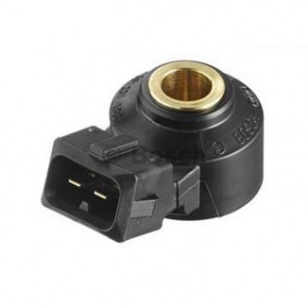

Run a knock sensor like me

I had a Knock (Detonation) display on my GTR which was very handy at showing the difference between various pump fuels. In my experience with it, bearing in mind it was a few years ago I found the Shell Premium fuel to be the best (producing least detonation) followed by the Tesco 99 and then the Esso Premium.
I did try the BP 102 and the detonation went through the roof so I always try to avoid BP.
Just my experience

Very good info, John.
Knock Sensors are quite cheap but I assume they connect into an existing wiring loom and ECU.
I have not seen a stand-alone system that includes a display.
Any ideas?
