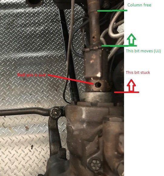

Damn thing. Final bit to remove and I just cant get it to budge. In desperation throwing it to the masses...
Issue is pretty simple - the coupler wont come off the steering box.
Column is free. Roll pin is out. Conventional internet wisdom says 'itll slide right off'. It does not. The only thing that moves is the little UJ thing in green. I cant lever the coupler as the surface on the steering box is too soft. Grips round the body and a tap with the persuader dont help. I cant get the box out without. :-k
In seriousness it could mean a change of plan and just keep as is. Its a shame as this is the time to get to it when there is no engine (HEADERS!) in the way. But if it aint budging I'm a little stuck.
Any ideas ?

All I can think of is that the splines are stuck due to corrosion. Heat might help....but that might damage the steering box seal?...but you are having that replaced...?
If you are fixing the box then you definitely should disassemble the coupler anyway , either to rebuild (cheap/easy) or at least inspect, clean, and regrease. So that would mean removing the metal cover (unbend the tangs) and then you could pull the column away and at least get that bit out of the equation and prove beyond doubt that it really is the splines.
At that point I guess you'd have to start strongarming it - can you put something in the way to pry against rather than the box itself? Have you soaked where the spline is with penetrant for a few days? If not I would def take that step next!!

the pin could potentially have mushroomed out the inner end of the hole through the splined pot coupler
i'd be wary, but a great big screw driver tapped down to get it moving might be the only method.
or someone hammered it on without cutting a master spline... in which case expect it to be stuck.

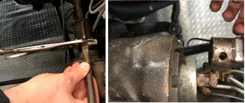

Chaps - Thanks so much. Today was turning into a grrr - but believe it or not that was inspirational.
You confirmed what I thought - nothing else SHOULD be holding it, so it was either stuck or another issue (which I would have to look at anyway).
With this new confidence I fashioned a cunning 'dont damage it' solution.
- Grips (not too tight) against the body of the UJ. The flare stops grips sliding, the grips mean minimal surface damage.
- Chisel onto the grips (not the box).
- Persuader onto the chisel.
Mein gott it began to move !! Few more taps and we were there.
Corroded is all. I am expecting to have to take it somewhere to get pitman arm pressed/tapped off but this bit I was expecting to be OK !!
Anyway. Top marks gents. Thanks.
PS - Not all the marks are me. As you might expect on a 50yr old car someones had a go before. The small fresh silver marks are me, the deeper stuff isnt.
