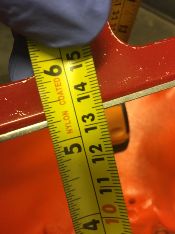

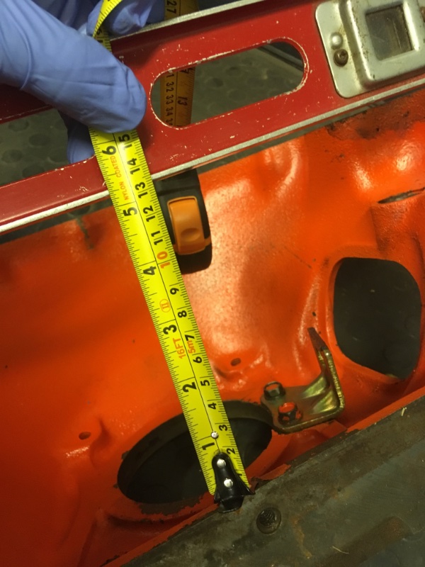

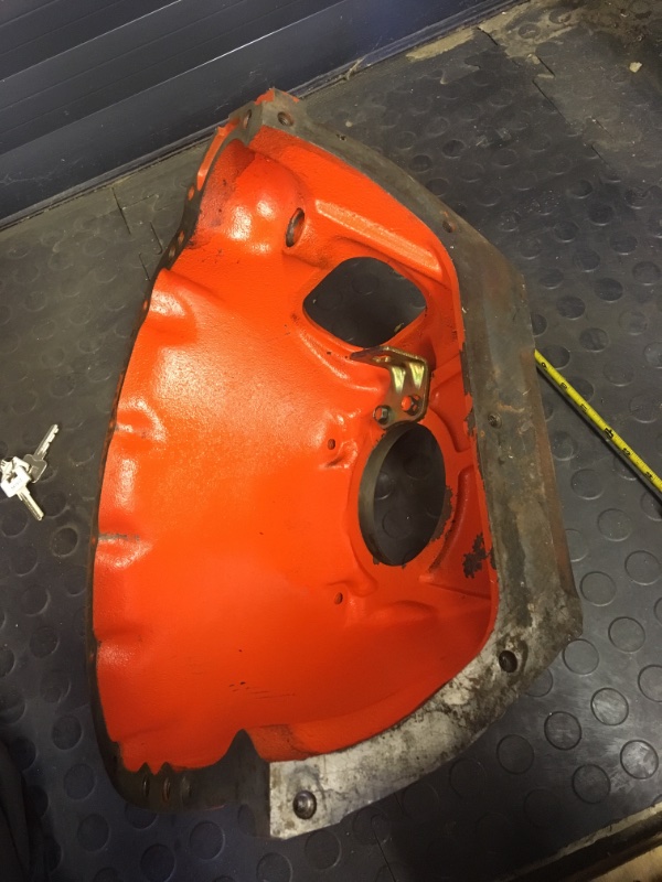

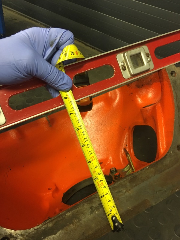

Posts: 14459
Re: Small block manual bell-housing dimensions
I have a car bell housing at home I can measure, it's cast iron but the transmission to block spacing will be the same as an aluminium car housing.

Posts: 14459
OK as you can see the car bell's are a different design...
TIB3300
Posts: 631
Location: Sheffield
Post by TIB3300 »
Thats great thanks :thumbright: well not great really, as I need to buy a car bellhousing now :?
That's 1.5in shallower than mine, that will make all the difference to where the T5 input shaft will be
