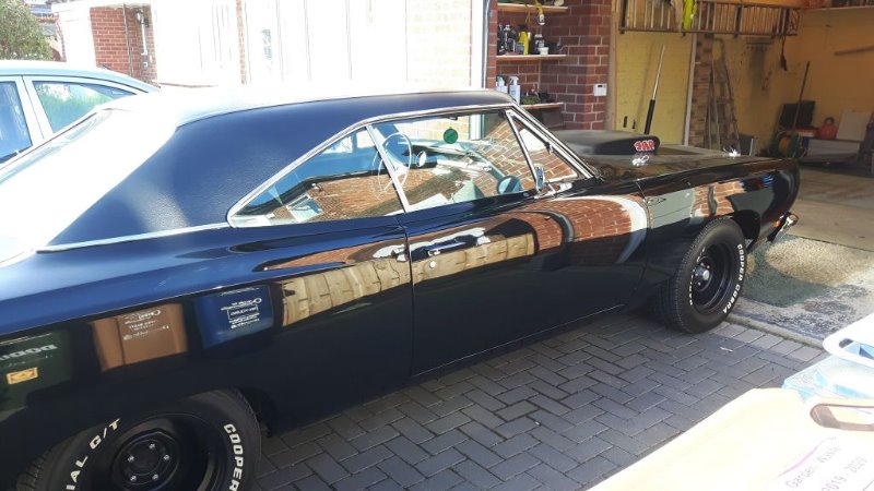

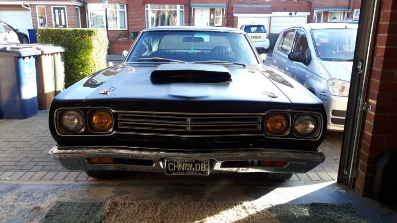

Right then.
Were to start?
Some pictures of this Plymouth Road Runner look-alike.
Were to start?

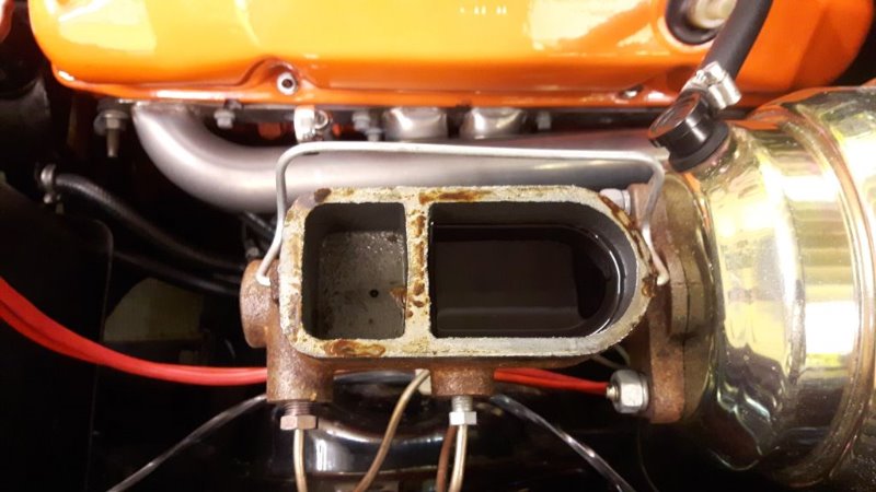

At the same time I checked the master cylinder as I did not feel happy with the brakes. There has been a previous "overflowing" of brake fluid from the master cylinder that has damaged the paint on the inner fender. No sign of a leak now but when I removed the cover from it it looks like perhaps the complete lack of brake fluid left in the master cylinder for the rear brakes might have been the cure for that symptom.

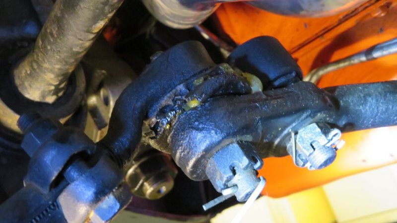

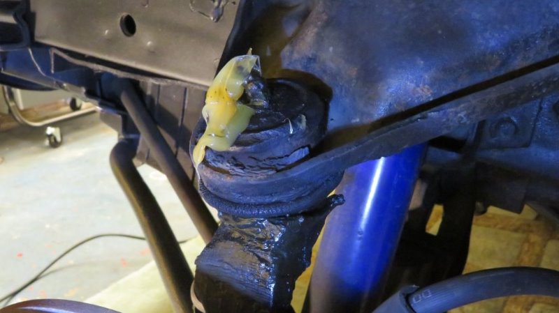

Couldn't help but notice they used all new ball joints during the quality restoration it had in the USA,
- 84777676_10158800569417699_8795945511556218880_o.jpg (57.76 KiB) Viewed 3983 times
- 85195722_10158800569427699_1419653881519931392_o.jpg (63.39 KiB) Viewed 3983 times
