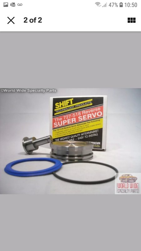

Anyone know if these are stocked anywhere in the UK? I've hunted but can't find any.
Superior Chrysler 727, 518, 46RE, 46RH Low & Reverse Steel Super Servo
Thanks!

why do you need that ???? a band in good order and adjustment set correctly there is no problem with the stock part, after rebuilding in excess off maybe 500 727 transmissions I have only seen about 3 that have broke,

Funny you should say that, the symptoms I had suggested it might be a problem (taking a while to get into reverse after starting.)
Had a butchers yesterday and it looks fine, and the bore isn't scuffed up or worn.
I'll give you a call to order a new filter and gasket, and maybe a new seal for the servo as it's out :thumbright:

as blue said you really only have to use one if the bore is worn it stops the piston cocking over thats all do have to use them

i ment to say only if the bore is worn
