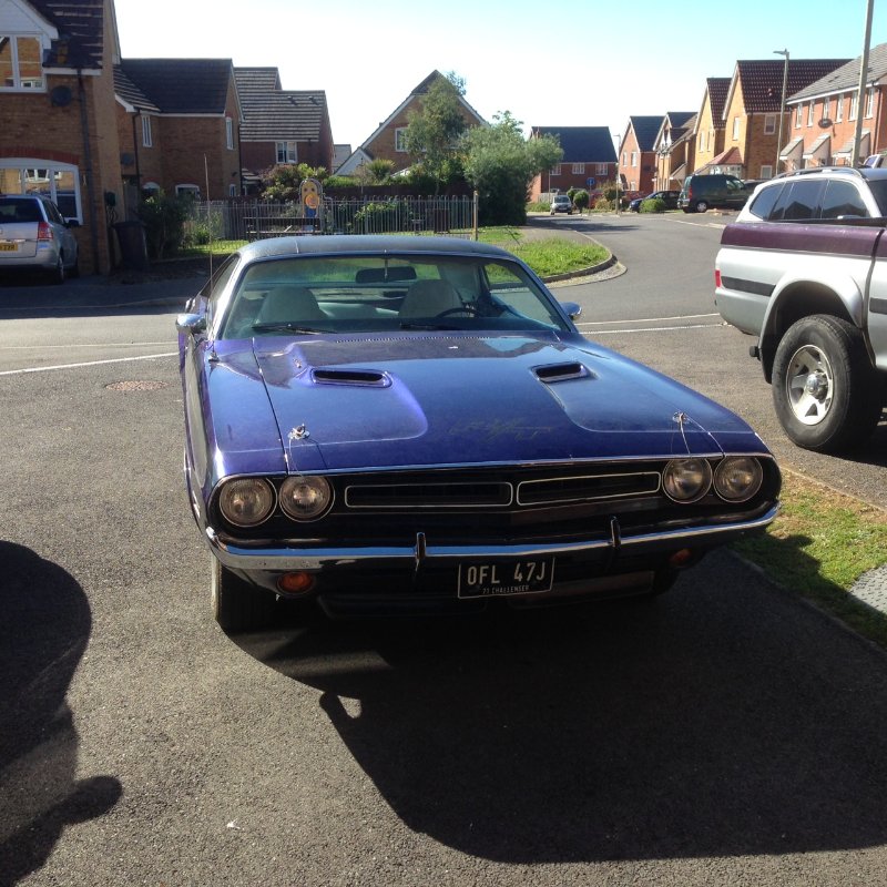

Been asked to put up some pics of my 71 340 RT , i brought the car spring 17 from a very nice guy from East Grinstead, who'd owned the old girl for around 15 years, he was genuinely very sad to see it go, having invested a great deal of time and cash into the old girl, at the time i'd just been offered a job at a brand new Restoration outfit based in Manston Kent, i decided to take the job on the bases that the money was better, so i could work less hours, be in the new bespoke workshop, mainly E Types and 120's etc, brand new state of the art paint booth/oven, and was told i could use the facility's to do my own car,

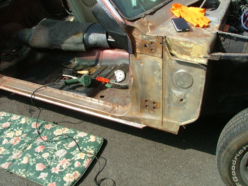

download/file.php?mode=view&id=128236r download/file.php?mode=view&id=128237

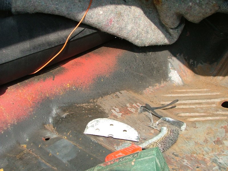

As purchased, the car drove very well, put a smile on my face the minute i turned the motor on!
So i start the lovely job of taking the shell, outside ,inside,and underneath back to bare metal, this is always a scary thing to do, old cars are like old ladies and generally look much better with there cloths on!

Ok reasons for bare metal, as with 90% of old cars thev'e been through the stage of being cheap, and that used to mean the boyooz's got hold of them, ragged them, messed them about, MOT rust repairs was also a big thing and as every one wanted welding done as cheap as possible they suffered rubbish but adequate repairs,
So the only way one knows what ones got is to get it naked!
This can and often is very scary, the paint,gob, undersill is gone, all the corrosion can now been seen , as can dodgy repairs/welding, crash damage etc.
This particular car had all the above but fortunately not to terrible.
Under workshop conditions i would have stripped it to a totally bare shell,and had it fully blasted, but that was completely out the question having to do it at home,

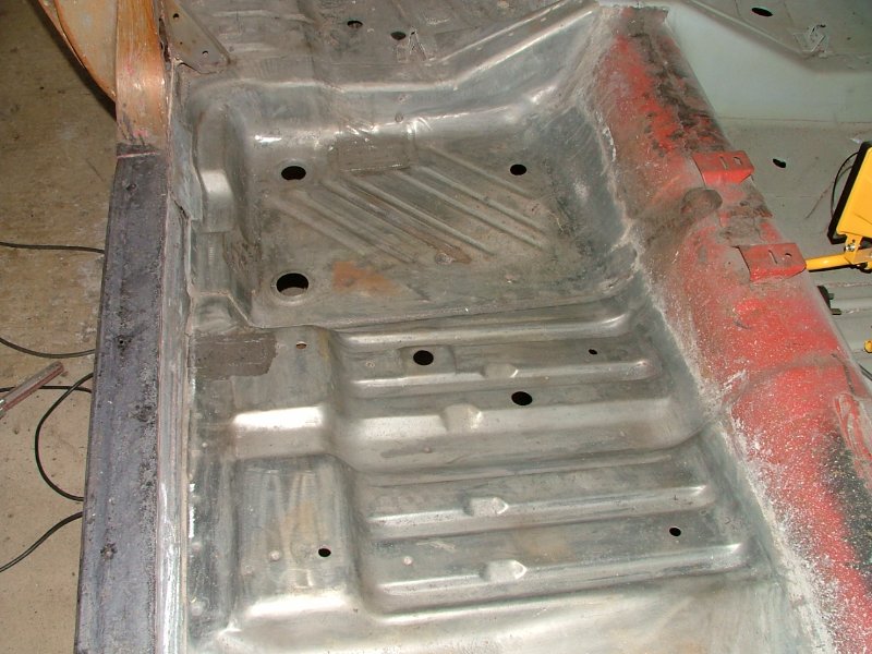

So the next very time consuming job was to Acid remove as much of the light/heavy corrosion from pretty much the whole shell, i used about 15 ltrs
its very expensive in small amounts but not to bad if you buy bigger lots.
Works really well, nasty stuff so one needs to be careful with use.
The other reasons for bare metal is the substrate is a none factor, so when the time comes to refinish the car all the etch,primers and finish coats can be properly matched, sinkage and reactions are virtually eliminated.

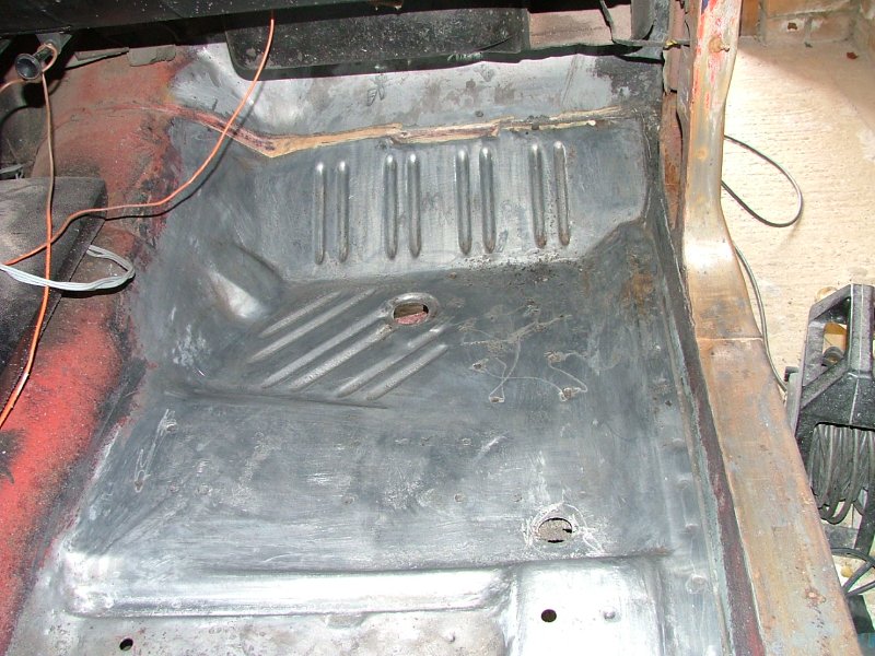

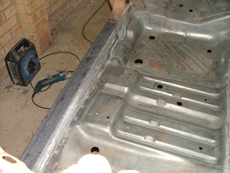

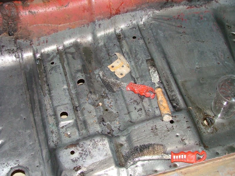

acid cleaning the floors.....download/file.php?mode=view&id=128244............

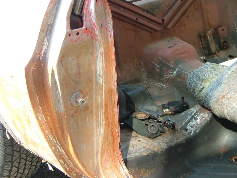

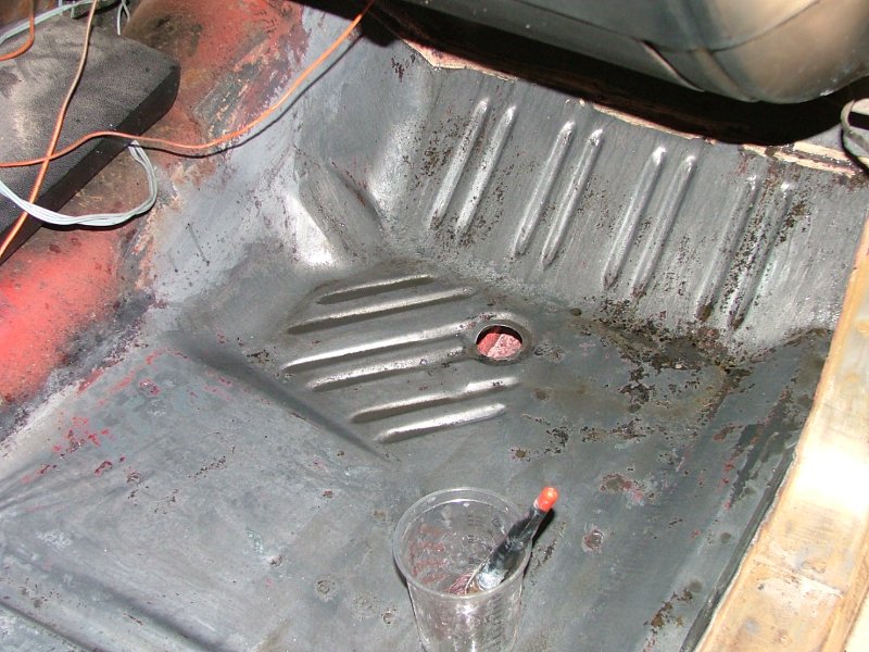

Two very small place that needed removing, both over the top of supports underneath,
i reinforced around the seat belt anchors purely as a precaution .
Rockers on both sides where completely sound on the exterior, and reasonable sound on the inside, ive a bore cam for my rifles so i had a look inside!
Things were looking good,

Re: 71 340 RT Challenge Driveway resto........

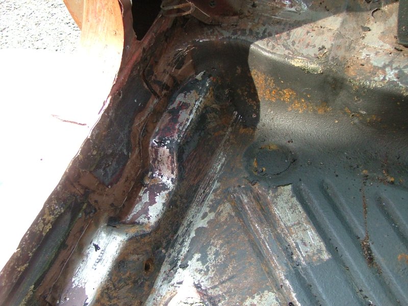

ihttps://www.moparuk.com/forums/download/file.ph ... id=128246n
Acid burn.....
You can just see the rust pitting , underneath the floors came up really very good, the part no are still visable!
Acid burn.....

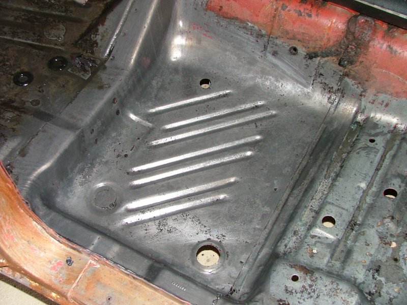

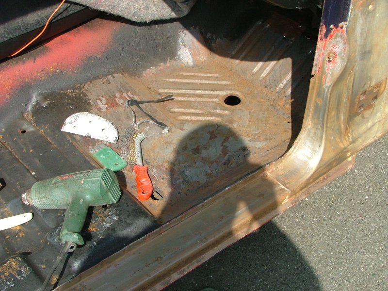

Small amount of pitting ahttps://www.moparuk.com/forums/download/file.ph ... id=128261t the front, but acceptable , so moved to the other side!
