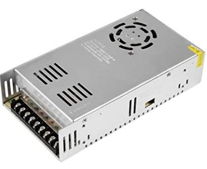

I know some of you guys know your onions when it comes to electronics. From time to time I need a source of 12V DC power to test or operate something on the car. Case in point is the convertible top motor which I’ve recently been finishing. In the past I’ve just used a car battery, but over the years they wear out and I’m not using it frequently. I had an old one which finally gave up the ghost.
I thought about using a mains powered 12V DC supply, and looked at converting an old PC Power supply (plenty of how-to’s on the net) which worked but did not supply the current I need. I reckon about 30-40 amps is necessary if it would work safely on my convertible top, or full beam headlamps etc (30 should be OK but may be better to have a safety factor?)
Anyway, I came across these on the web – they are popular for LED strip lights etc. Can get 30 amps for a decent price, 40 is a bit more. On the surface it looks like the ideal solution, but wanted to check with someone knowledgeable in case I’m missing something (surge protections, inrush currents etc).
Does this seem like a plan or have I missed something?

Re: Advice required on 12V power supply...
Thanks Dave, I thought you might chip in, very helpful and as usual a bonus to think about!
Since this is mainly about a cheap/durable alternative to a battery, the one I posted is £18 delivered for 30A, still a fair bit less than the Lithium battery option.
The circuit breaker in the Dodge is 30A for the convertible top, and 20A for headlights. So I imagine that a PSU of 30A should be enough, though could get a 40A version for another few quid (eg )
The spec on the amazon link says:
Product Features:
Auto on/off cooling fan
High efficiency
Low temperature
LED indicator for power on
Over Load and Short Circuit Protection
Over Voltage Protection
Output:
DC Voltage: 12V
Rated Current: 30A
Current Range: 0-30A
Rated Power: 360W
Ripple & Noise (maximun): 150mV
Voltage Adjustable Range: 10-13.2V
Voltage Tolerance: +/- 2.0%
Line Regulation: +/- 0.5%
Load Regulation: +/- 0.5%
Setup, Rise, Hold Up Time: 200ms, 50ms, 20ms at full load
Input:
Voltage Range: 90-132V AC / 180-264V AC by Switch 248-370V DC
Frequency Range: 47-63Hz
Efficiency: 74%
AC Current: 6.5A/115V 4A/230V
Inrush Current: 25A/115V 50A/230V
Leakage Current: <3.5mA/240VAC
So only real question is whether the circuit breaker has a 'slow blow' which doesn't care about a few ms of 40? 50? 100? Amps but the Power supply would care, and would either blow up or cut out and not work for this purpose - don't know if those specs shed any light on that?

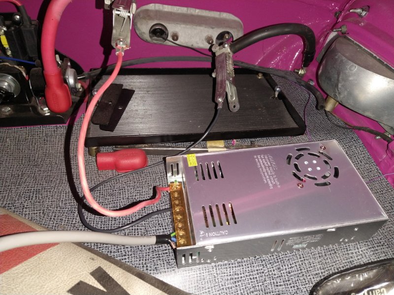

Thanks all, I ordered a 40A supply for about £25, it arrived and I wired it up and it works perfectly, runs the convertible top motor (actually quicker than my battery ever did) without blowing anything up, so I'm all set
Smaller, cheaper, less (=no) maintenance and much longer life than battery so for my purposes, job done.
