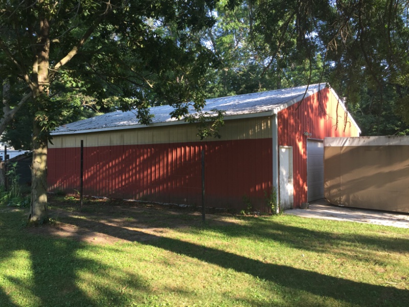

Figure I’ll start with this thread, since I spend more time working on upgrading this than I do on actual project cars.
Welcome to my workshop, or at least it will be when I’ve finished it.
32’x48’ pole barn. I thought it was going to be an easy upgrade when we moved in, insulate the walls, epoxy the floor, stuff a gas space heater in it.... nope.
- The workshop
- image.jpg (229.56 KiB) Viewed 2576 times

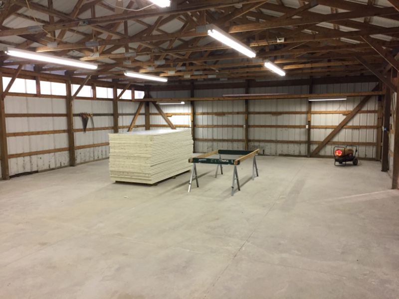

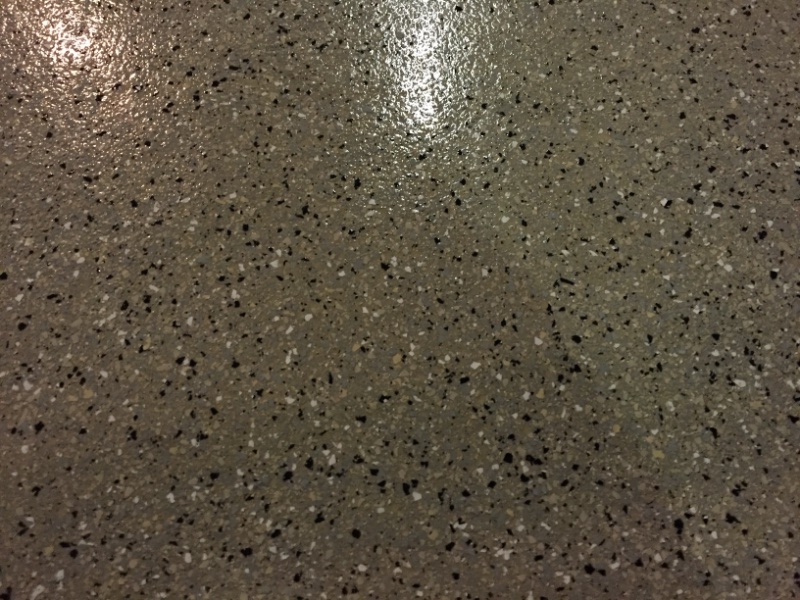

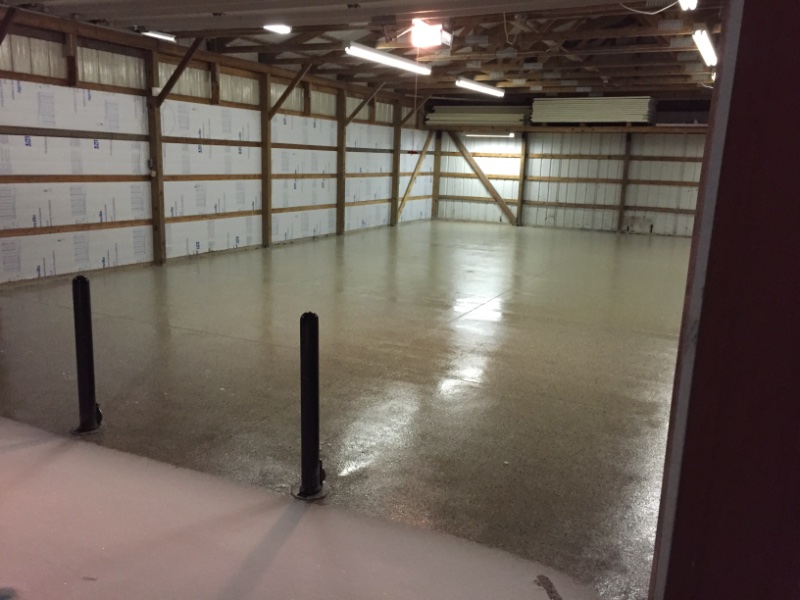

The Floor:
So looking at the property the previous owner had used the barn for a wood shop to chop logs down for the wood fireplace in the house (different story), thus the concrete floor was covered in about 1/4” of sawdust.
Once I swept it out I realized the floor was complete junk. Now my entire shop budget was in jeopardy to replace the floor.
If I’m going to do it, I’m going to do it so I can park a tank on it. What we have now is 6” of 4500psi concrete with fiber mesh and rebar. Then I coated it with something that isn’t epoxy, supposed to be better. We’ll wait and see on that.
What you are looking at here is 50 yards of concrete!

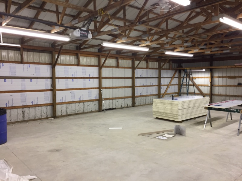

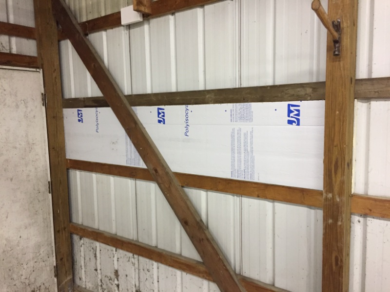

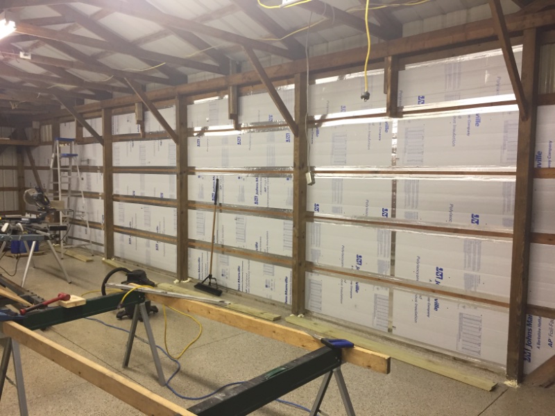

Insulation - Phase 1:
Now I have spent all my money on the floor things are going to really slow down. Gone is the ambition of having other people complete the project.
Because Michigan has less than optimal temperatures for much of the year insulation is a must if I ever want to use this shop. Those of you that remember my Indiana barn will recall tales of tools and parts sweating whilst running the heater in winter and the complete inability to even go in it during summer! A couple of you will even remember my first barn when we moved to Michigan, it was perfect! Full insulation with a full hvac system, lovely!
The plan for this one is to land somewhere between the 2. That means less serious hvac and more insulation to make up for it.
The easiest way to get the job done here is to use spray in insulation, but that stuff is horrible, if you ever want to change the wall or roof panels you basically have to chisel them out. I could frame the walls then use blow in insulation, but knowing the local rodent population that would end up making a perfect home for them.
So I decided to do it the hard way. 1.5” closed cell foam (with foil face) between the girts (or is it purlins) of the walls to effectively seal the outside surface. That prevents the rodent incursion, plus the foil face is halfway to a vapor barrier. Then frame the inside and add batt insulation. I made a spreadsheet and everything, this works out the cheapest way to 30+R.
Picures show the phase 1 closed cell foam installation. Because this barn was hand built over 30 years ago nothing is really straight, so each panel has to be custom measured and cut.
- FDBD1D15-42AC-4BBE-9B8F-6A4481C2BE67.jpeg (135.11 KiB) Viewed 2540 times
- 5F8289ED-4909-4AD5-9D73-5AED1A414D3D.jpeg (155.64 KiB) Viewed 2540 times
- F79A3066-AA3B-432B-B8FF-49412EC88A37.jpeg (142.49 KiB) Viewed 2540 times

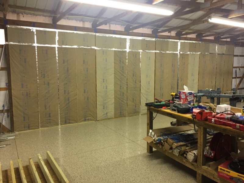

Re: James’ Barn of Destiny
Phase 1 Complete - On this wall at least.
- 5432E842-6421-4F31-AF40-7E8A31CE8B6B.jpeg (169.32 KiB) Viewed 2539 times

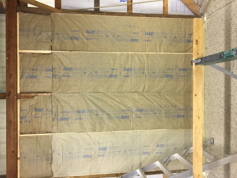

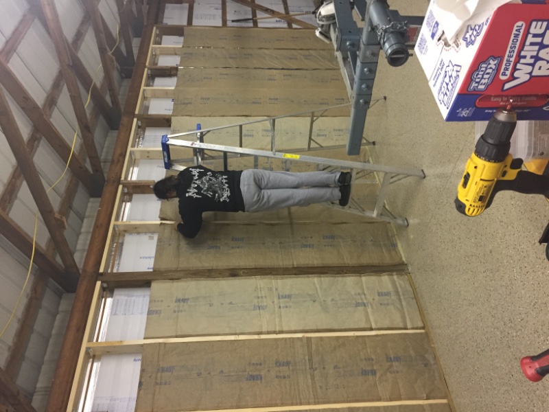

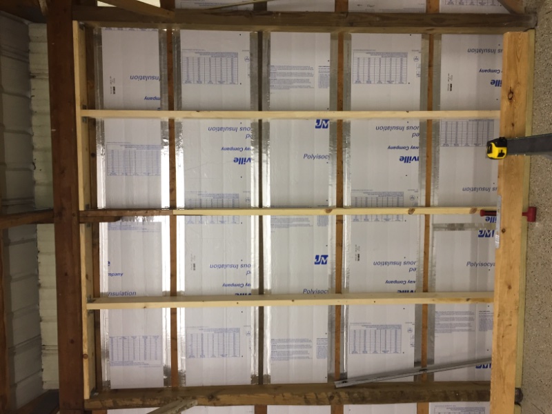

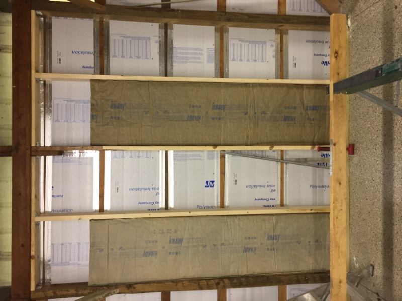

Phase 2 Insulation - Framing and Batts.
With the outer walls done with the closed cell and all the edges sealed with tape, it’s time to start framing and putting the batts in.
Bear in mind the framing is providing no structural support, it’s just there to hold the insulation in. Before anyone points out how crap my building work is
Phase 2 Complete - On this wall at least.

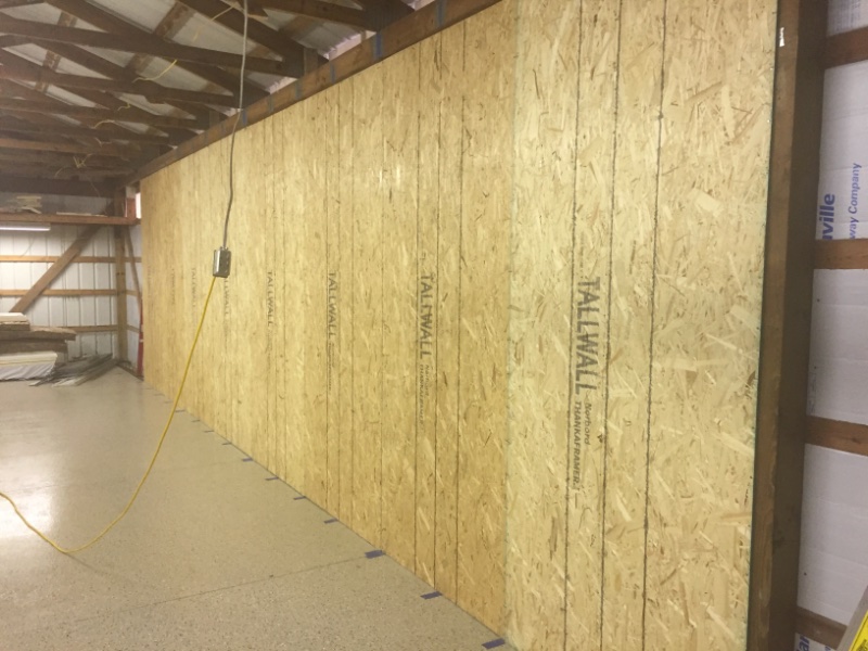

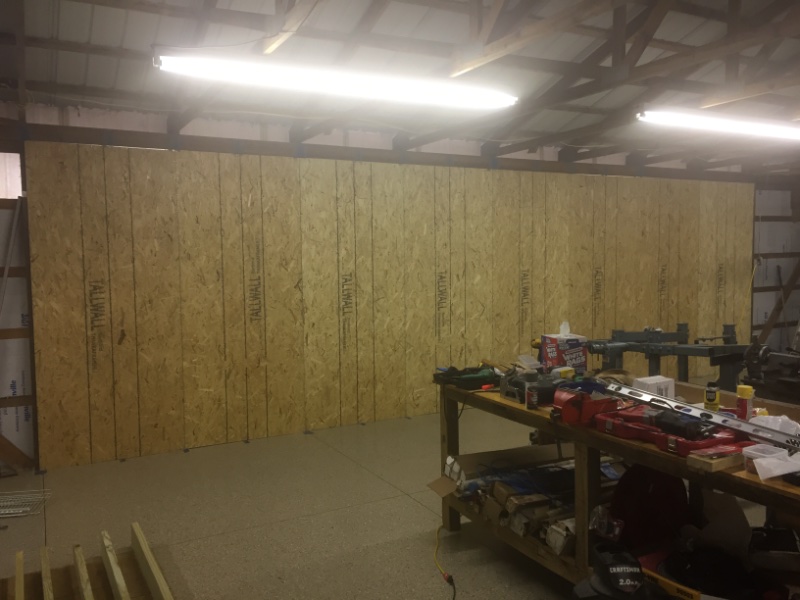

Insulation Phase 3 - Inner walls.
Pretty straight forward here. A flammable 7/16” OSB to cover the flammable insulation. Perfect for a place I intend to weld and grind in!
We’ll fix that later.
Hand nailing all this is making me reassess my dislike of electric/air nail guns.
- A9B8CA50-A6FE-4689-8E50-4391BF30BEA0.jpeg (124.79 KiB) Viewed 2535 times
- 86DC5F6C-CD6B-459A-8C91-38AF6EB2651B.jpeg (158.24 KiB) Viewed 2535 times

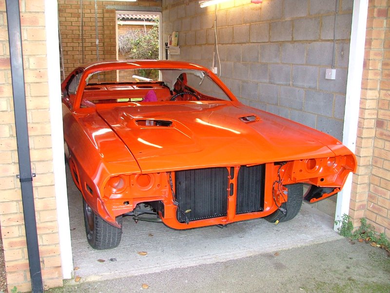

Imagine how many rusty parts of broken Charger I could litter round THAT place !
Its the space around the car I'd love. Imagine being able to just work around it, with the doors wide open etc.
Nope. I stick with my first assessment. That's not fair !!!!
