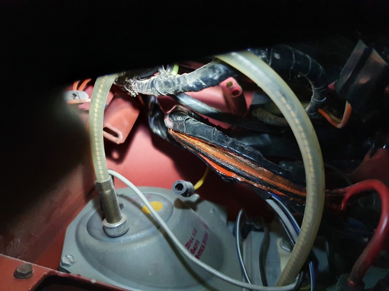

Pic of my melted wiring harness; finally identified the cause of why my dash lights were always on forcing me to disconnect the battery when not in use. Just ordered reproduction harness from YearOne. Appreciate any inputs on best way to replace the harness; I'm assuming that it's probably best to remove the dash?

Is that the ammeter wire that has melted through?
That is the normal culprit and worth bypassing it when you re-install.
Steve did a great how to article on here. I know your car is very original, but the whole ammeter wire thing is a big problem on our cars.

Yes I did read Steve's very informative article and I do plan on bypassing the ammeter when installing the new harness as I do believe the ammeter may have been the cause of my melted harness. I'm also running the heavy gauge wire from the alternator to the starter solenoid to take some of the amperage load off the wires running thru the bulkhead connector.

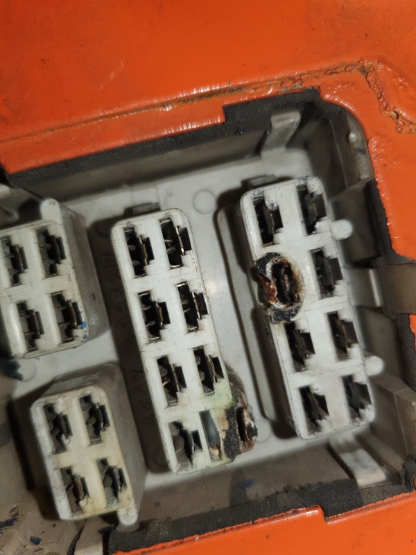

Pic of the junction box showing the typical burned connectors for the two main power circuits.
Posts: 1674
Re: Challenger Dash Wiring Harness
Mine only had the two "4 block" connectors left, the rest was a hacked rewire the obvious result of a harness fire.

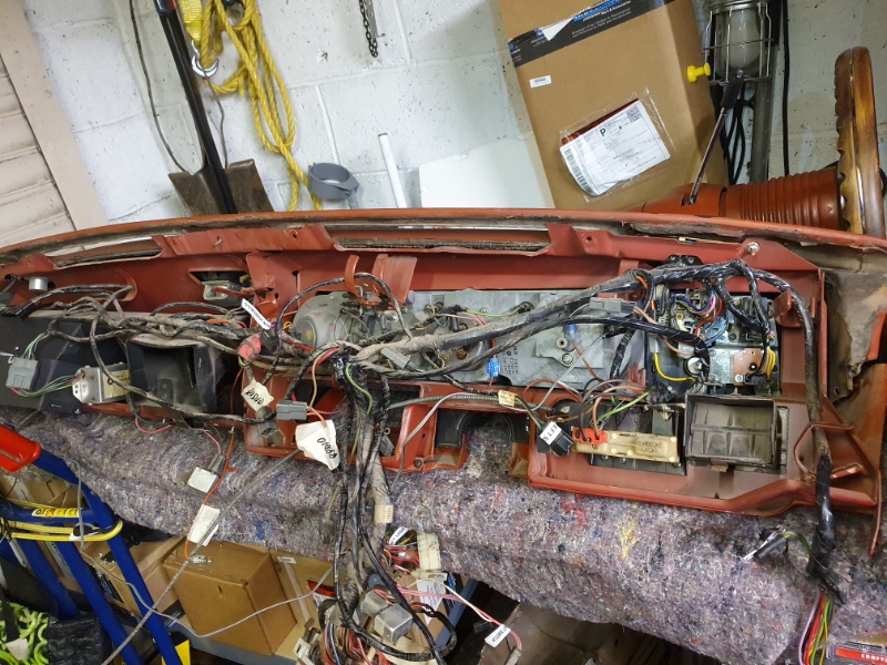

Got the dash out today, found another melted portion of the wiring harness. Now just waiting for the new harness to arrive from YearOne,
Posts: 5893
Good work there, take lots of pictures so it all goes back!
