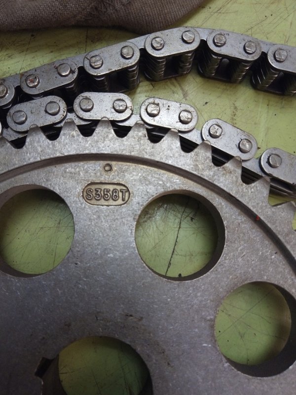

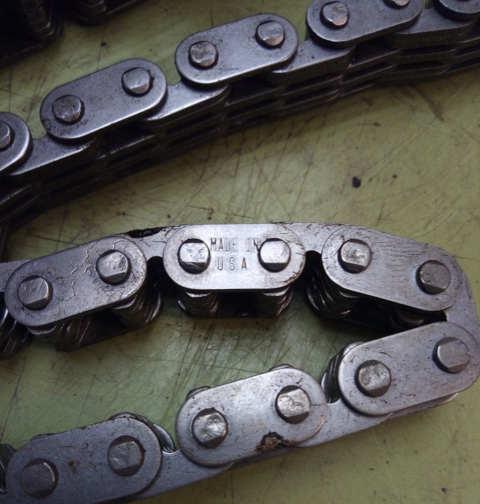

Have you seen this make befor? any good ?Pete wrote: Sun Nov 29, 20 9:12 pm Quite possibly, and a re-balance.
Worth looking at a stroker rotating assembly as once you have weighed up the parts and machining cost you are not a million miles away from a 440 source unit - and it is all new and balanced with rings and bearings.
You really need to check everything that the previous owner has done / had done, as they clearly have cut corners on the Pistons / Rings and Bores.
That timing set does not look great either - hard to see from the pictures but I would only ever fit a double roller if I was not using Gear / Belt drive....

Personally I would not use one of those = I think they are called a "Hyvo" style and are designed to run more quietly - they are of cheap manufacture and I would only use a Double Roller Timing chain or a Belt or Gears.
It is amazing how quickly the set ups wear in a v8 with no tensioner, but they seem to keep working...

ThanksPete wrote: Wed Dec 02, 20 5:11 pm Personally I would not use one of those = I think they are called a "Hyvo" style and are designed to run more quietly - they are of cheap manufacture and I would only use a Double Roller Timing chain or a Belt or Gears.
Where would one get a Double Roller chain ?
What name to look out for?

I used Romac aussie gears with German IWIS chain.
also sold in the US for 318s etc under the ROLLMASTER brand
the one you took out looks like an aftermarket copy of the standard type or maybe the standard one. nothing wrong with them but better exists for little extra outlay and much less stretch in use
