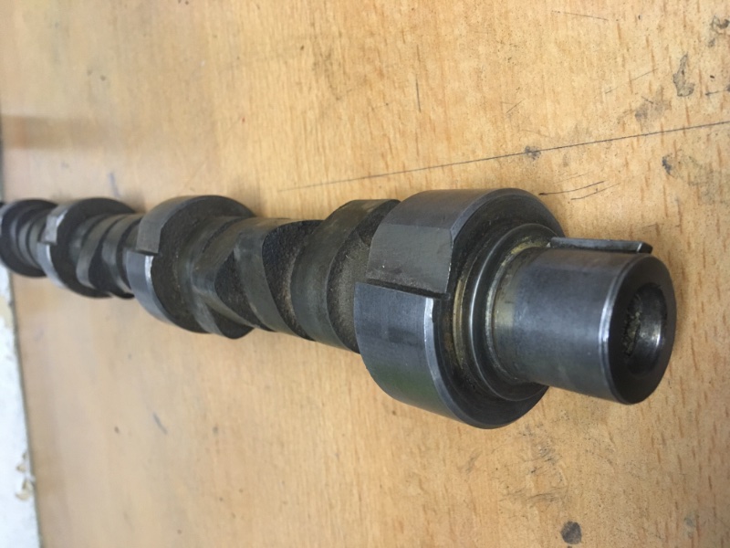

Thanks BlueBlue wrote: Fri Jan 08, 21 3:19 pm When you change cam bearings you need to use an old cam to ream them to size, they will be too tight otherwise.
I had read this and yes its a bit tight, but I can turn it with a spanner. As you said stick and old cam in there first
Re: MAHLE cam bearings too big
I'd say if you can't turn it easily with the sprocket bolted to it it's too tight. You are not just reaming the bearings to size, you're also ensuring they are in line.
- IMG_0536.JPG (140.21 KiB) Viewed 1854 times
