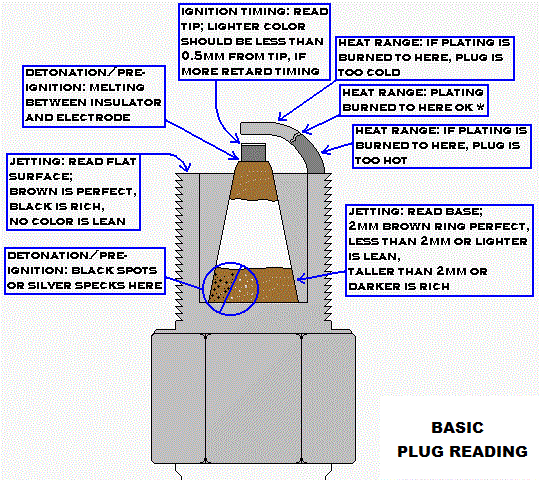

Take the car for a run on a fast road and then read the plugs earth strap, that will tell you for sure if the plug is too hot, too cold or just right for your application.
Posts: 5927
Re: spark plug heat dissipation
That's a great diagram Blue, more informative than even the Haynes photos.
Posts: 14537
It's very handy and reading the plug for heat range is the easiest bit of all.
