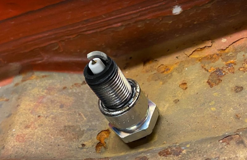

From what i have just read,my spark plugs say the timing is too high,idle circuit is too rich and the jets are too small.
I have a new roller chain to put on,so i will see what it runs like after its fitted.
Re: Does this engine sound right to you?
My two pennyworth,
Looking at that plug it is getting too hot, possibly due to timing or even weak fuel mix, IMO its only the fact its a quality plug that has held things together. Is the heat range correct? check if there is a coloured band around the base of the electrode insulator, if there is that would indicate heat range is close.
Try more fuel and less timing, something is going to melt if this is from a high speed plug chop, Maybe just a blocked jet but needs immediate attention.

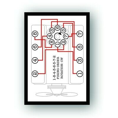

this the the point when no.1 has both valves closed and the distributor rotor is pointing at least to the correct half of the distributor cap for no.1 cylinder.
adjust distributor round to that no.1 cylinder contact is directly above the rotor. draw a line on the body and cap to help align
then check that the leads, starting with no.1 put it in its position above the rotor and then connect up the rest in the right order.
see if it starts
then set timing.
if the vacuum can hits something leave timing as it is with Vacuum can hitting whatver it hit
do this process again you will probably find that you chose the wrong dizzy tower for no.1 and the dizzy needs turning back away from the thing it hit
adjust the wires by moving everything round 1 place and re set with no.1 over the rotor at TDC. again rota should point somewhere in the correct half of the dizzy for no.1 tower

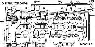

there is some kind of rule of thumb for this on a small block. i have never owned one so take this with a pinch of salt
as far as i know at TDC the distributor drive should be pointing at the drivers side headlamp....I think someone with 318 V8 experience necessary here to confirm,
see attached
think this is for or the drive under distributor, but that would get rotor pointing totally at n0.1 or totally away from no.1. if totally away, wind engine over to TDC from here, to both valves closed).
In theory it doesn't matter where the drive is but in this case to sort out the issue i think it best of this is checked.
see if it starts
then set timing.
reset the timing properly
see attached
back to the book settings is best when things are weird
- firing order.jpg (21.51 KiB) Viewed 4946 times
- LA rotor.jpg (23.03 KiB) Viewed 4946 times

if all else fails do this to check TDC timing mark on balancer, as Dave B says the outer on the balancer could have slipped
get old spark plug (or safer buy a piston stop tool with the correct spark plug thread (or at least a set of adaptors)) either will do
spark plug method
smash out the middle and snap off the earth strap crack off the top so you are left with just the metal body
put bolt through plug so its end sticks out where the spark used to be made and secure it with a nylock
you want it 1/2 -1 inch longer than the plug used to be it needs to stop the piston reaching the top of the bore
https://www.ebay.co.uk/itm/333801863746 ... AfEALw_wcB
stop tool is safer
wind No1 to the bottom of its bore
fit your modified plug or tool
carefully wind engine forwards until you modified spark plug stops the piston
go to timing tab on timing cover. there is a hole in it use a centre punch to ding the balancer through the hole. make a precise mark that you can see easily draw a line near it with nail varnish or paint pen so you can find it easily again
wind the engine over backwards carefully
until no. 1 cylinder stops again i.e approach your modified plug from the other way
repeat the marking process on the balancer
Remove modified plug
