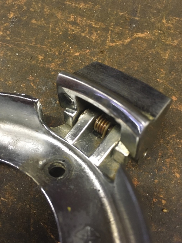

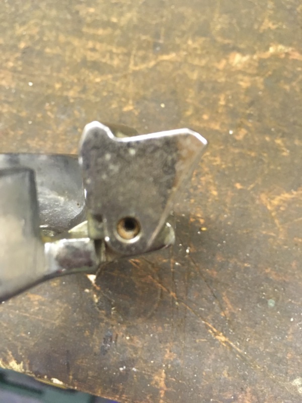

How do I remove a blind roll pin from a Charger fuel cap, it only small so I can’t just screw in a screw and put it out.

You will need a Punch of the correct dimensions, otherwise you may distort the end and jam it in even harder.

can’t punch it out Pete, one end is blindPete wrote: Wed Jul 21, 21 8:32 pm You will need a Punch of the correct dimensions, otherwise you may distort the end and jam it in even harder.

Sorry, I scan read it, maybe a stud extractor but I have not had a lot of luck with them.....
Re: Roll pin removal
Can you not drill it out? or do you think you might damage the dodgy ally casting?

Nasty, looks like a bit of rust on the end in the first pic, so it's going to be tough old spring steel instead of softish stainless. You could try a stud extractor first, but don't wind it in to far or you'll expand the pin and make it even harder to pull. If it feels kike it's got a hold, get some mole grips on the extractor and try tapping it out. If not, and you have a suitable sized tap it might be worth trying to cut a few turns of thread inside it, then you could use a bit of studding or a screw to cobble up a sort of slide slide hammer to try and pull it out. Failing that try drilling it out. If the worst happens and the extractor, tap or drill break off in there, you'll have to mark up and drill the other side of the latch so you can punch it out and either live with the hole, or turn up a little bung in ally to fill it up again. When you buy a new roll pin, I'd try and get a stainless one.

Good point Dom, it probably is hardened.

Just another thought, why are you wanting to remove it? If it's to replace the spring because it's broken, you could try using a (probably sacrificial) par of electrical side cutters to chop out the spring coil by coil and then perhaps grip the exposed pin enough to pull it out far enough to get a grip on the end...

Small cutting wheel or diamond grinding bit in a Dremel to cut the spring if side cutters won't fit?

I had a similar task a few years ago on a motorbike. I took it to a local engineering firm who gave it to the shop apprentice to drill out in a pillar drill. He was supervised and did a great job. He ran a slightly smaller drill than the diameter of the pin in and the heat etc eventually loosened the pin and it began to spin with the drill. He kept it running and slowly withdrew the drill. The remains of the pin just fell off the drill. He logged everything as a 'project' for his qualification and I signed it for him. He also had a beer out of it as per the old rules

Heat it and cool it a few times
penetrateing oil for a few days
you need a punch that fits down its middle a pin punch with an inset end might work
although i have just used a ground down screwdriver in the past
you fill the hole with grease. normal wheel bearing grease anything you like, tune the thickness to the amount of leakage past your punch.....
you can't compress grease so it will come out....
you put the punch on top of the grease in the hole. and the punch needs to fit nicely in the hole
and you hit the punch with a masons hammer as hard as you bloody well can or dare....
wear glasses
you will have a lot of freckles by the time you are done
as some of it will come out of the split in the pin
hydraulic action will slowly raise the pin
repeat by re applying grease

if its a true roll pin you won't be drilling it... they are rock hard. well.... so hard in comparison to the surrounding pot metal that you risk pocketing the hole and doing no damage to the pin...I think you would need it mill it..set up correctly and perfectly with a tiny milling tool
