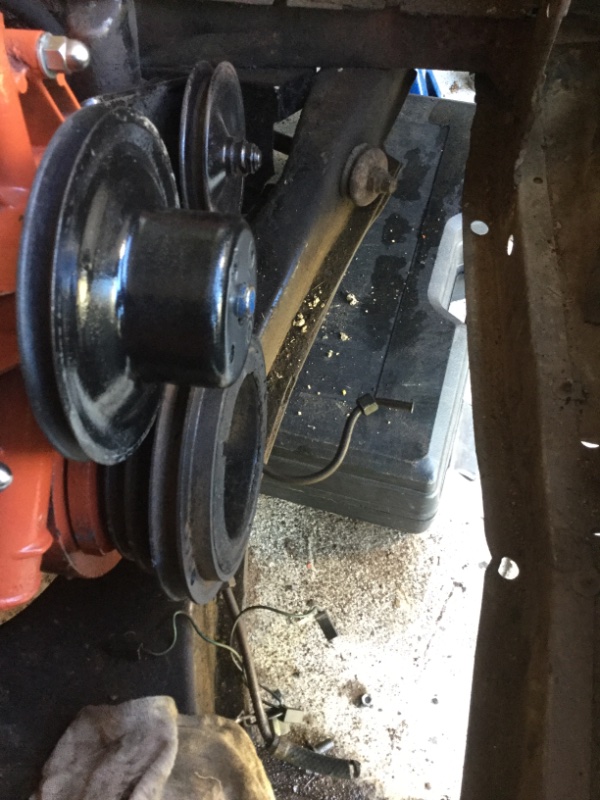

It was all the same Blue. I’ve included a pic of the 318 set up as it was in the car before, it shows the water pump pulley sittin behind the crank pulley whic I cant establish now.
I’ve used a spacer under the crank pulley which has bought me some minor clearance, but I know need to take a Drexel to the water pump snout a touch to get clearance there.
