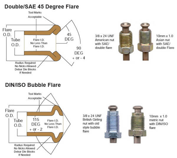

Hope someone can help please
I'm going to be making some replacement rear brake pipes for my pals 66 Fury. Does anyone know what sequence I need to use with this machine to get the correct double flare? I will be using 3/16" pipe. I'm guessing its OP1 3/16 followed by OP2 3/16 but would be nice to have a bit of reassurance from someone who has made them recently if possible. I can do some tests and match it to the originals but any advice would be gratefully accepted!

Re: Brake Pipe Flaring
Yes, Op 1 & Op 2
Don’t forget to fit tube nuts before flaring 😋

Posts: 9567
make shure you get correct tube nuts.. no lead in before the thread as far as i can remeber.
with hindsight you might have been the person who told me that :)
work on everything apart from you have 2 special ones for the Master cylinder
