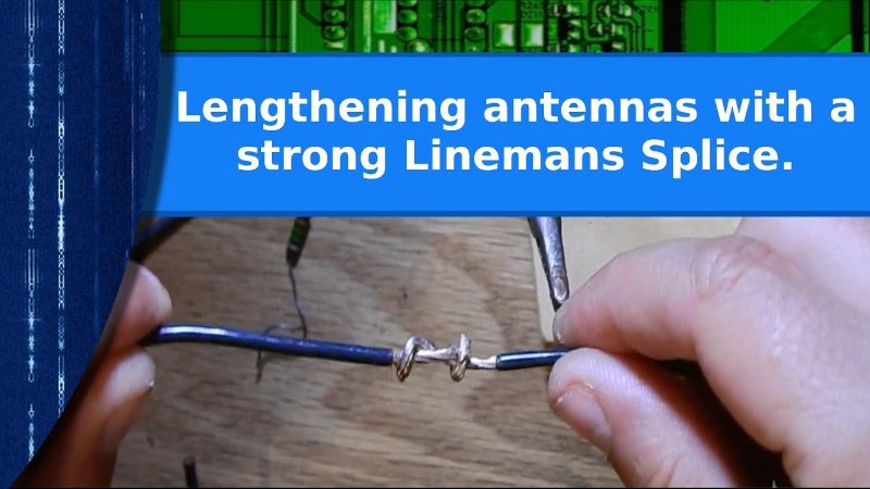

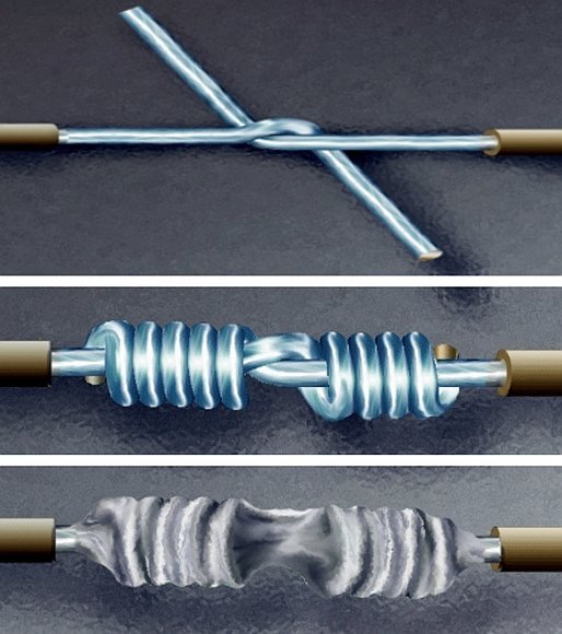

Use the linemans splice to join the wires after slipping some shrink tube over. With stranded wire you will need to twist each free end to make it more like solid core. see below you should end up with a join no fatter than the wire and insulation either side, so you can slip the heat shrink over and shrink it
its all they did in the factory (minus the heat shrink) never wasted even the smallest length of wire. just hid it and its joins in the middle under the wrap where you can't see it. see pictures
shrink the tube over the join

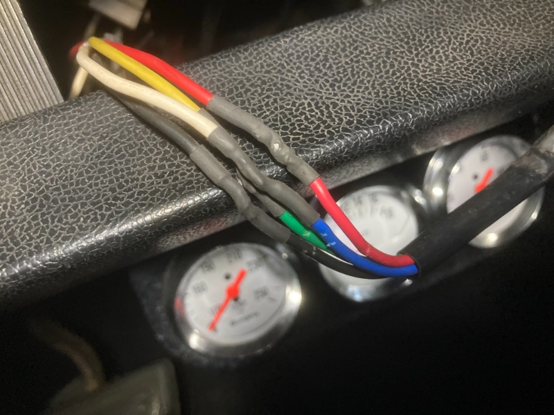

Here’s what I’ve got at the moment, I had planned to basically cut the joints, route the tach up through the dash speaker hole and rejoin the wires to the same ones they came from. [-o<

that picture you have is a perfect wireing diagram so you can connect the coloured wires the correct way.... store it off in a folder somehwre called wireing my car

Dave999 wrote: Tue Oct 05, 21 1:57 pm that picture you have is a perfect wireing diagram so you can connect the coloured wires the correct way.... store it off in a folder somehwre called wireing my car
Yep, I figured it was the easiest way. Snip, reroute, reconnect to same colours (note to self, try and remember 20 years ago soldering lessons) and cross fingers it still works. :D
