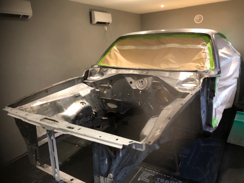

So it begins
Quick update
Has been sleeping in mum and dads garage awaiting attention since 2005 when I snagged it off Matt Hollingsworth
Built another garage in the back garden to carry out the work will post updates as they happen
1972 Chrysler Valiant Charger 770 -1006 Magnum 360 Rocket ship

Looks a nice place to work, keep the photos coming :thumbright:
Posts: 7516
Re: Valiant charger restoration
Hey Terry, good to see back on here, also good to see you getting something done at last.
Lovely workshop,wish mine was as tidy.
Looking forward to the updates 👍

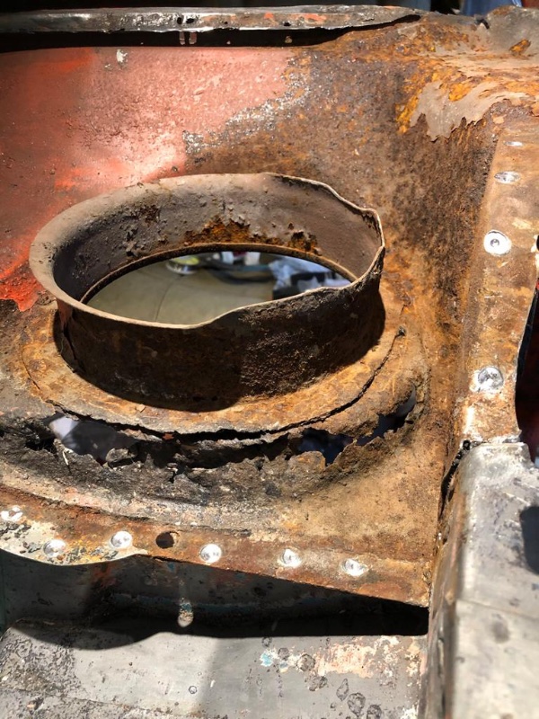

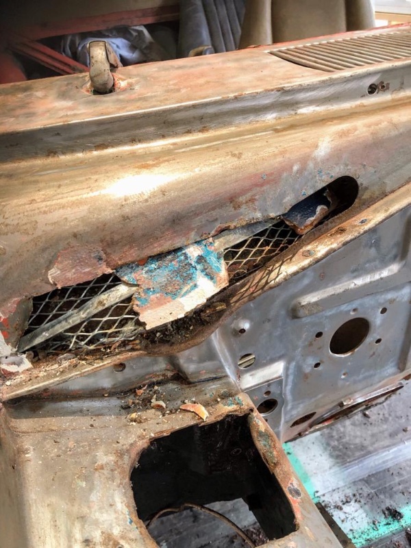

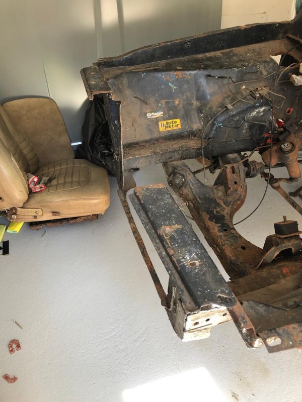

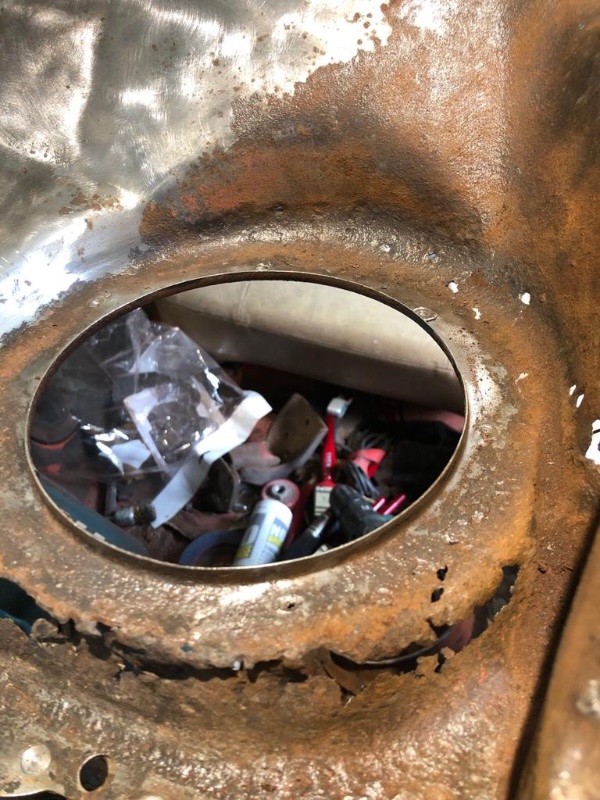

Well as I expected plenty of rust in the usual Aus charger places
As you will see they have covered the only access to the drains and the plenum areas filled up with water
Render corner beads are for rendering not something to mould grp and filler round
Also knocked a bloody great hole through the inner wing

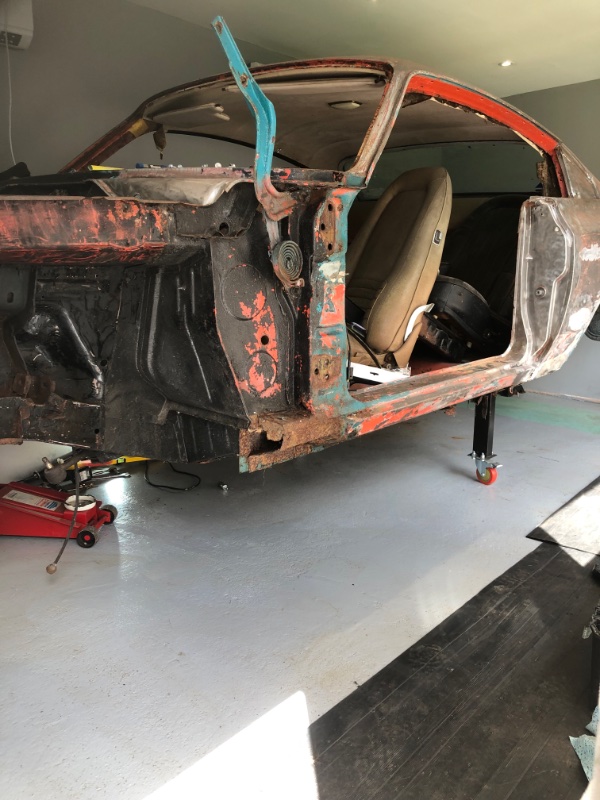

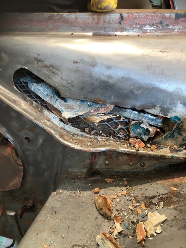

Removed from panel to access plenum area as I can see plenty of rust inside

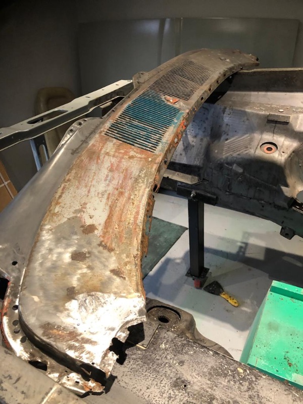

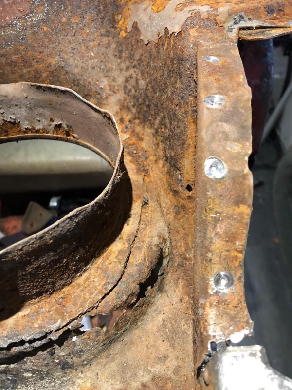

Must have been filled up to the wiper’s with water at some point

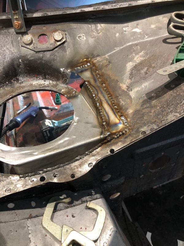

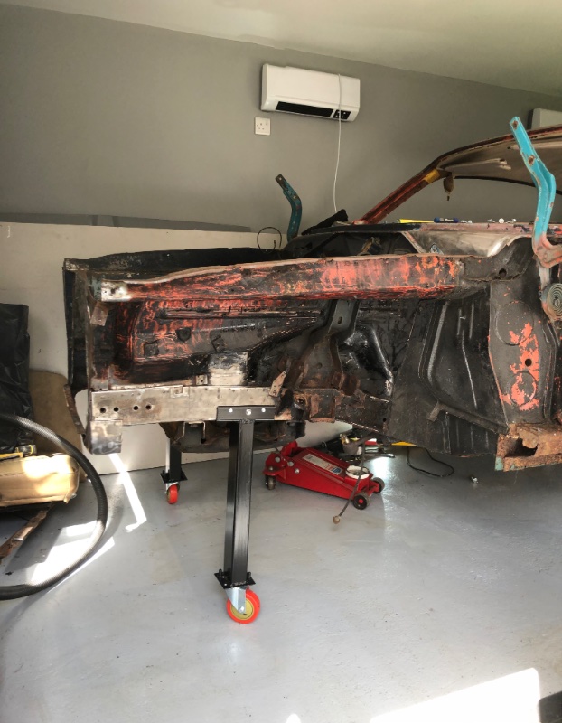

Front structural cross member was cut through as well as the lower radiator panel
Got a good straight second hand one that needed a few welding repairs

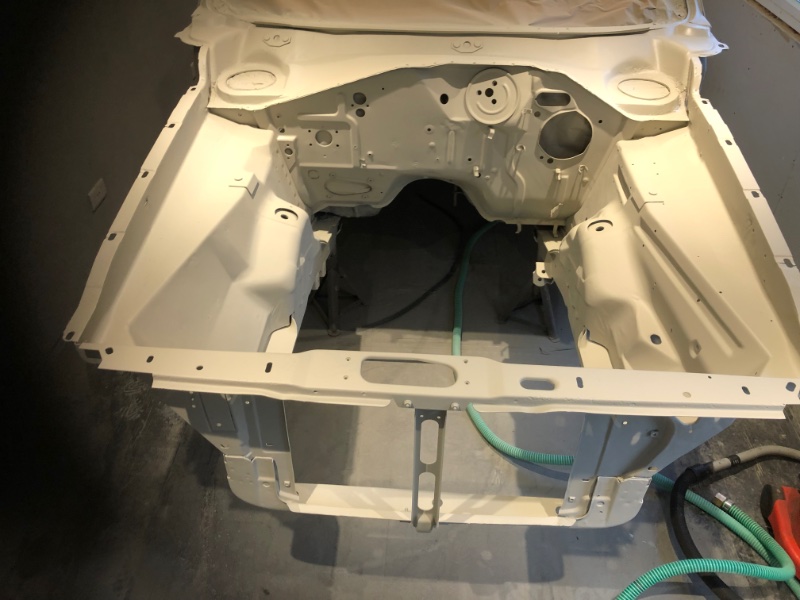

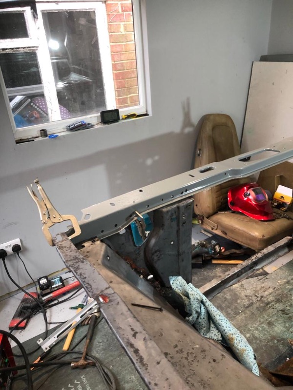

Yes Dave the usual spots
Plenum area is a lot worse than minty
Front area is 90% complete
Lot’s of metal patches and plenum area has been repaired
Has had two coats of Mipa epoxy while I attack the rest of it
I thought Jack had his hands full with other projects 🙂
Door cards are shot ,the back seats are in good condition
Front seats need recovering
