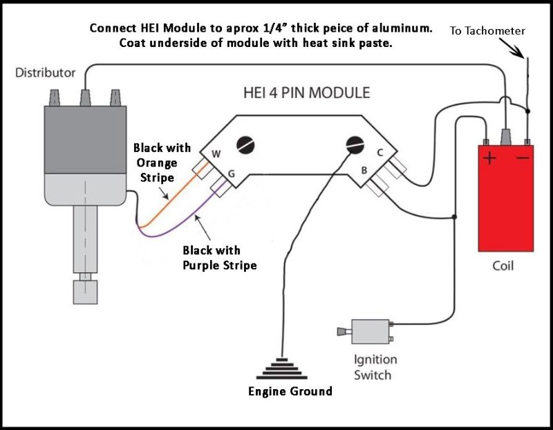

I have not worked on an HEI set up (other than on Chubbies at work) so not sure how this is wired.
However, on an MSD unit, you can disconnect the output wires from the Dizzy and if you short out the wires to the Amplifier / ECU with the power on, it will produce a spark - thus proving it on or off the Dizzy.
It may be worth trying this on your set up to see if it helps diagnosis.
In my opinion it is pointing to the Dizzy and maybe the reluctor has failed (uncommon but it could happen) or it has been bridge by coming loose against the "chopper".
Posts: 7599
Re: No Spark
Brilliant Pete, that's certainly something for me to look at tomw. It's wired exactly as the standard HEI upgrade a few years ago and has worked a treat ever since...
