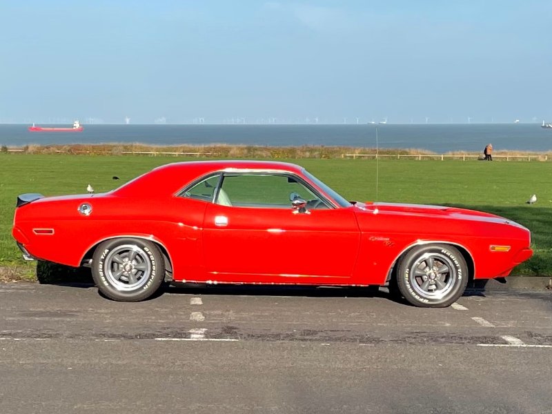

Yep got 235 60 BFG's on my Chally, sitting on 8" rims, slightly wider on the rears, stance is pretty much spot on,
download/file.php?mode=view&id=142289
No rubbing , even on neg camber roundabouts we seem to have down here!
- IMG_0250 (2).jpg (101.17 KiB) Viewed 1156 times

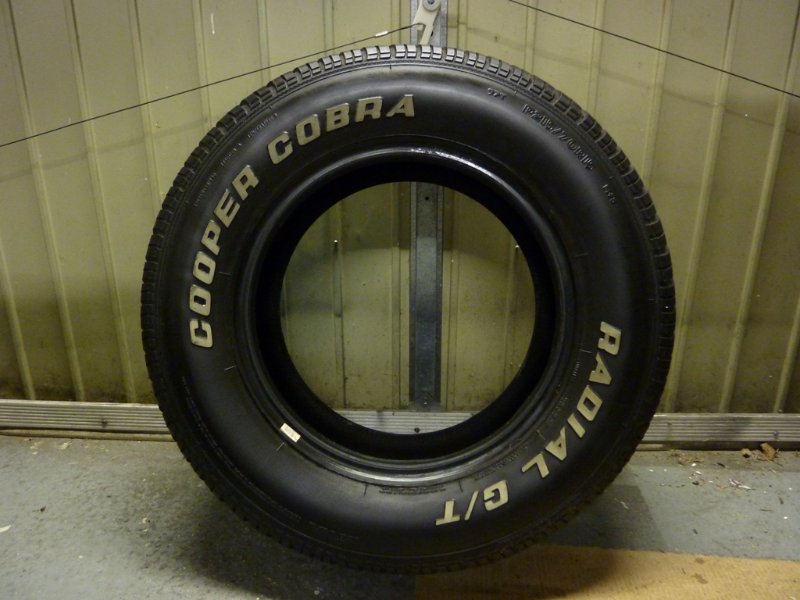

Hi Pete, I have a pair of Coopers 215/70/15. Very little use. Let me know if of any interest. I could measure the o/a height.Pete wrote: Wed Feb 23, 22 7:51 pm Brilliant, thanks Martin.
Looking at availability, I might knock it back to 215 x 70 x 15, so it gives a balanced look in terms of height with the rears.
Thanks again!
- COOPER4.JPG (82.19 KiB) Viewed 1114 times

Wow! That may fit the bill if they have not gone hard.Stu Twin wrote: Thu Feb 24, 22 1:30 pmHi Pete, I have a pair of Coopers 215/70/15. Very little use. Let me know if of any interest. I could measure the o/a height.Pete wrote: Wed Feb 23, 22 7:51 pm Brilliant, thanks Martin.
Thanks again!
Please can you PM me a price please and if possible the date code on them, thanks!!!
Cheers!!
