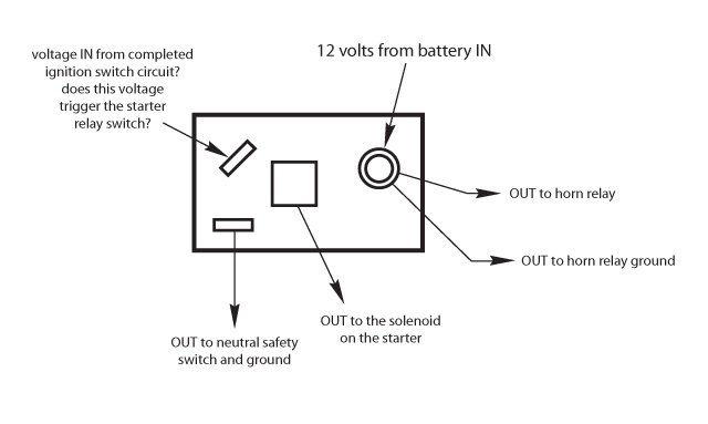

Unless it is a Race car (and they are often wired the same way!!!) The MAIN power for the Starter Motor is wired directly from the Battery.
Please see the attached diagram for the rest of the wiring.
Good luck.

That's how I have the starter wired up. The car was running before the short incident and nothing has been changed since but now the only sound I hear is the single click from the starter relay located on the firewall when the key is turned to the crank position.

The old trick (After you have absolutely confirmed the car is in NEUTRAL) is to get a screwdriver and Short out the BATT and SOL Terminals on the Starter Relay. The Motor should immediately crank. We have had to do that in the Fire up lanes a few times!!

Try directly earthing the connection on the solenoid that goes to the neutral safety switch to rule that out. Screwdriver across the bat and sol terminals and it should crank. If it doesn’t, your issue is narrowed down to the main lead to the starter, the starter itself and the engine earth.

Had this issue with a mates Dodge on Sunday. Same solution as Pete and Blue suggest. Fired straight up with ignition on and shorting the solenoid out. I also probed for voltage on the yellow wire which was good for ignition as the key was turned to full start position. Suspect a NSS issue. Had the same with my Roadrunner a few years back. Seems to be quite common.
A power probe is a really useful tool for this sort of issue.

I had a similar problem, it turned out to be the wire from the bulkhead connector to the starter solenoid as Blue suggested it may be.
