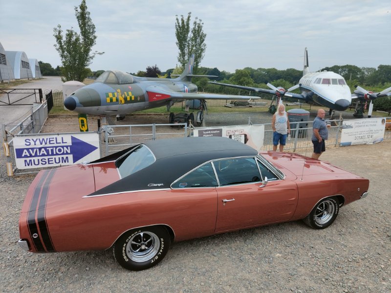

Posts: 1398
Re: Wheels and tyres

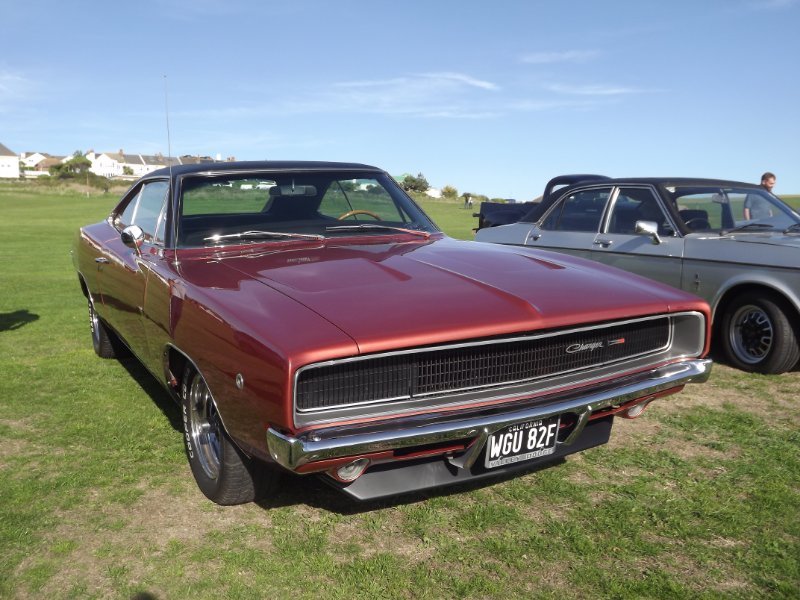

I'd send Derek a 'pm' and ask what he has on his 68 Charger.
His 15" Magnums fill the arches nicely and look to have the all-important correct offset:
Posts: 7516
Cheers Stu. I have 8x15 with 275 x 60 x 15 tyre on the rear and 7x15 with 235 x 60 x15 tyres on the front, hope this helps

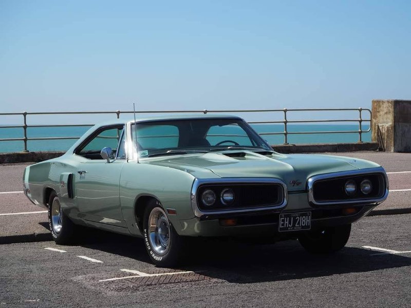

275/60 on 15x8 will go under the back of a 69/70 Coronet with plenty of room to spare if the wheels have zero offset (i.e. 4" backspace).
235/60x15 on the front will give you a slight rake, though you can always adjust the ride height with the torsion bars. If you want a level stance, a better starting point is 225/70x15, which are almost the same height as 275/60x15. The taller tyres also avoid the problem of a vertical gap between tyre and wheel arch (a pet hate for me!).
That's what I went with: 275/60 on 15x8 rear, 225/70 on 15x7 front...

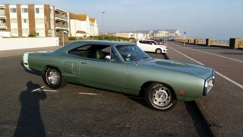

Adam have you any pictures side on Thanks Pat
Adam
Posts: 3431
Post by Adam »
Here you go Pat...
