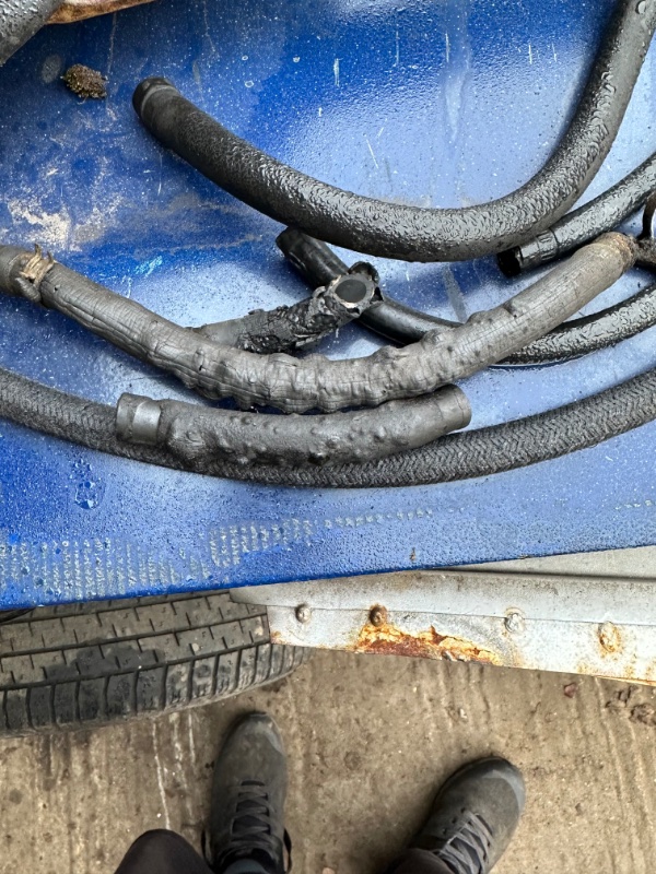

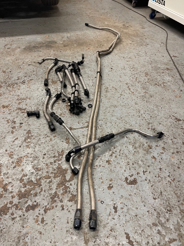

Dodge charger 68
Complete fuel system only 6 years old
Torques (EBay) AN10 hose - feed and return
Cheap pump gas only E10

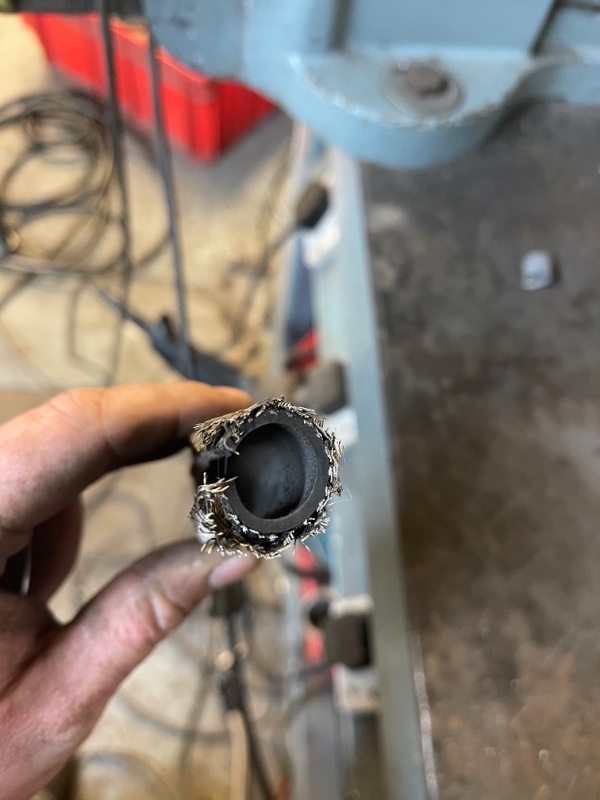

Car gets used very little and has sat for 3 years with fuel in the lines

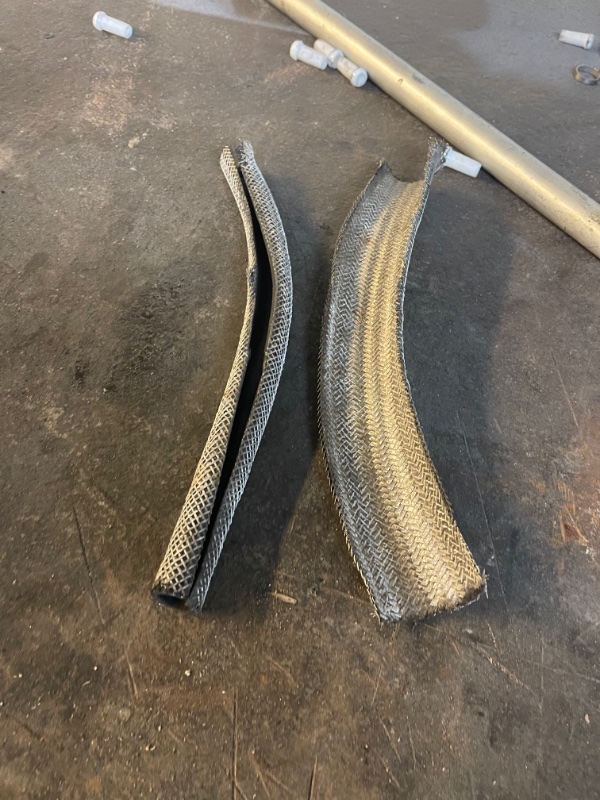

Went to start it up and all the fuel lines are Bananarama! fuel
Seems the E10 has rotted all the lines !!!
I can’t believe it - check yours :(

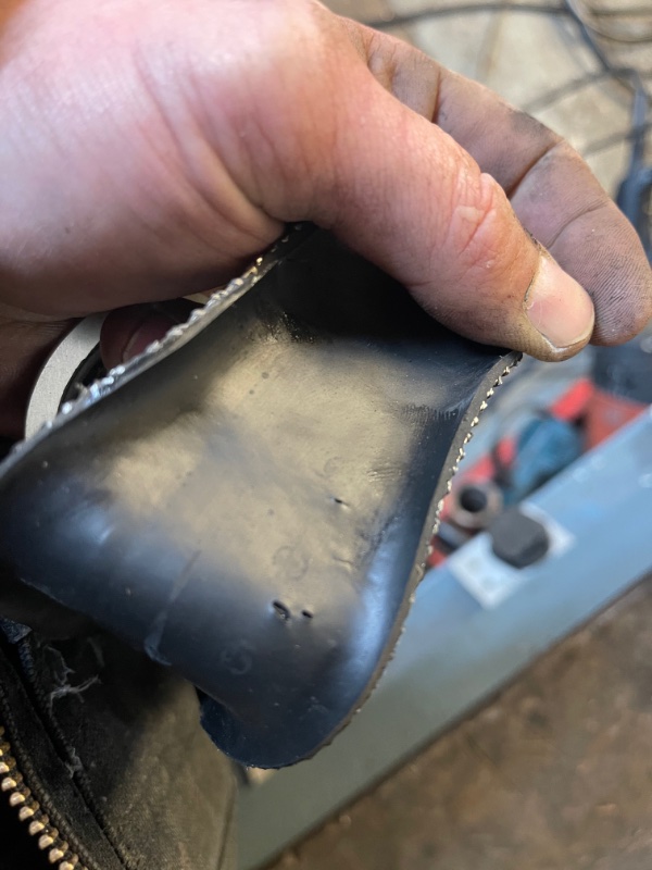

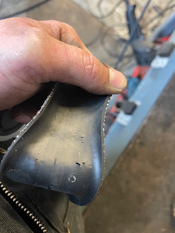

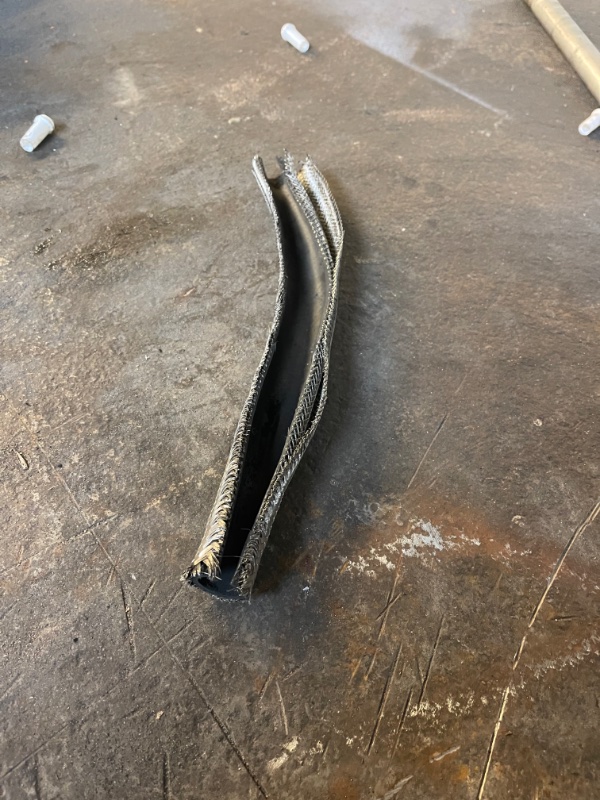

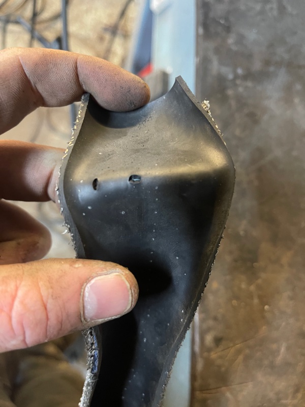

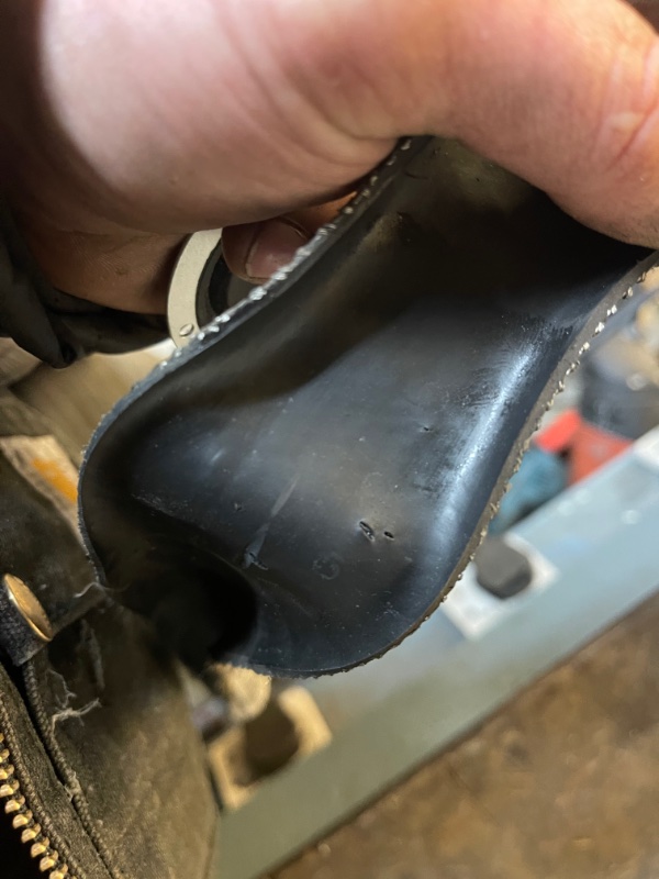

Yes, we had a Corvette with EFI and AN Hoses in the garage, it had stood a long time before the customer sent it to us (From Spain!!).
EFI runs at least 45 psi with the pump in the tank, and when went to start the car, there was fuel all over the place as the main line went porous.

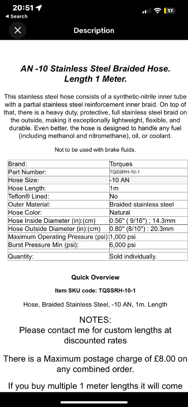

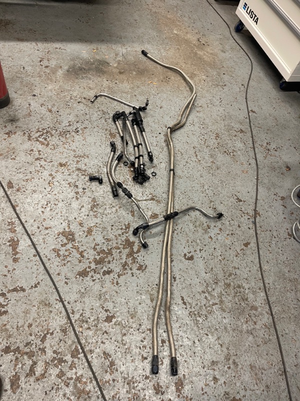

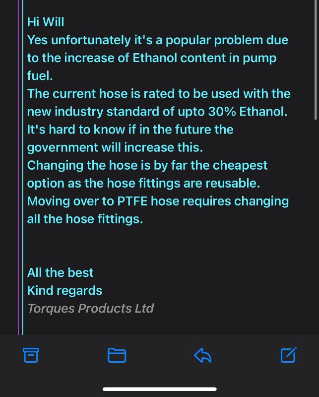

On the above guidance, when I had to re-do the fuel system on the Challenger (to meet "revised Scrutineering requirements) I followed "Torques" Advice and installed all Teflon pipes and new fittings.
The only good thing is that the new lines are far less bulky and an AN-10 Line looks like and AN-6 old style line.
That's progress for you....

I hope you have better luck than me, quite a few years back, I ran Torques fitting on my fuel supply. System was fine when starting up, no leaks, etc.
If I left it a week or so & fittings would leak till they had soaked with fuel, leak would then stop. I obviously wasn’t a fan of fuel spraying out, so stepped up to BMRS Fiitings & limes, never had an issue since.
I also had an issue with their black hose going hard on any of the oil lines.
I know others have used Torques with success, so good luck

I've used Torques exclusively for several years now without issue, but I don't use E10. Given all the internet chatter about E10 attacking fuel lines and the probability that the ethanol percentage in pump fuel is liable to increase as time goes on, I'm now using teflon lined hose.
