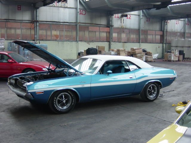

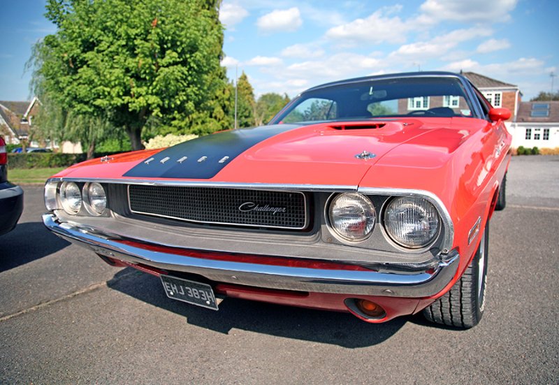

Here is the front of mine pre Re-Paint...
Posts: 7128
Re: 1970 Challenger grill
It’s a bit hard to tell from there. :lol:

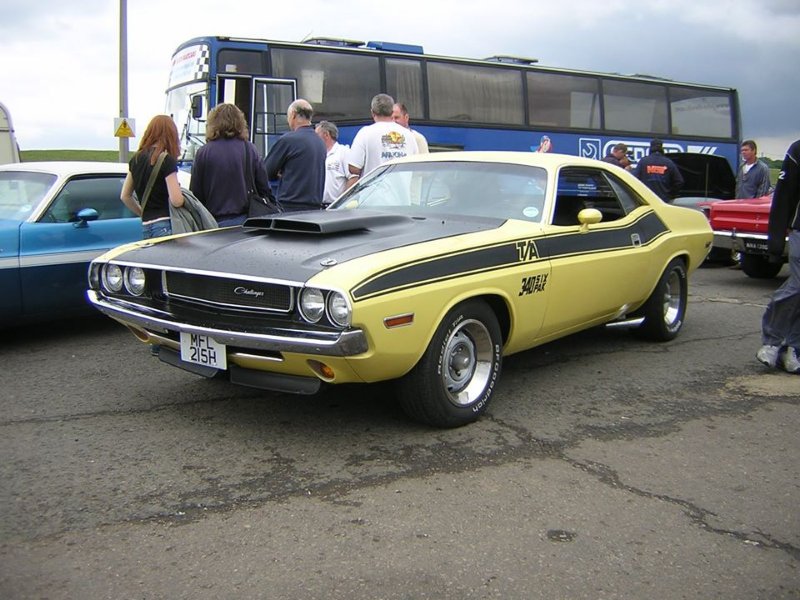

,, and to back that up, here is a Picture of my old T/A....

Yes, agree the T/A &R/T definitely all black.
