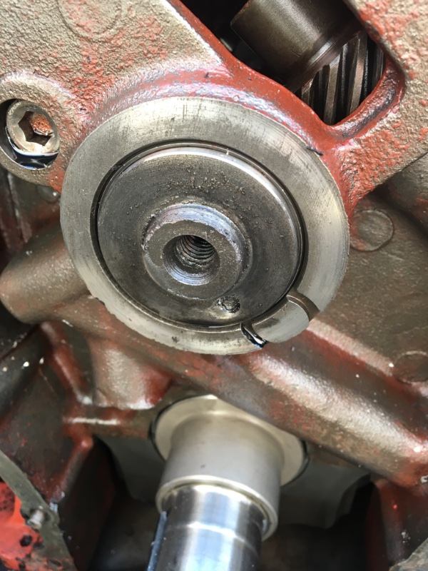

Stripped Scott’s Satellite down yesterday and found this, can you see what’s missing.

Wooduff / Pin??
VVT???

Broken pin for the timing sprocket.

You got it, broken pin. Chain snapped and It’s chewed up end of camshaft and inner timing cover.

How are the valves and Push Rods feeling about that?

Pete wrote: Thu Jun 08, 23 1:41 pm How are the valves and Push Rods feeling about that?
Hopefully going to get time to to strip it down start of next week. Camshaft, lifters and so on already ordered.

Fingers crossed, let the autopsy begin....

Not to bad when it was pulled apart, one inlet and one exhaust valve on each side, new cam ext on way, going to put the spare pair of Ali heads on then order new valves and those heads become the spare heads

Could be a lot worse, crack on, lads!
