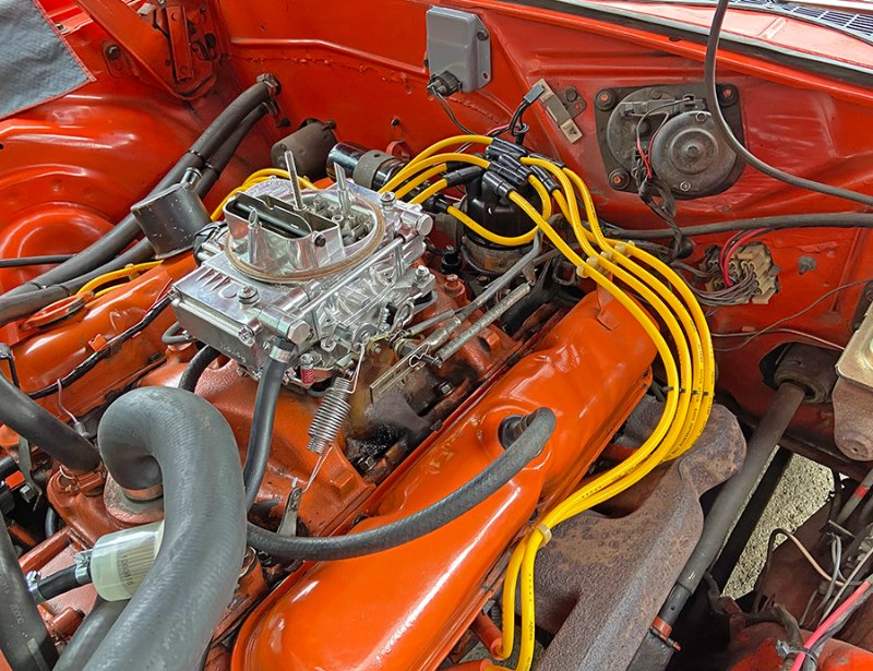

Re: Ignition cables
Went with Accel Super Stock in the end.

Re: Ignition cables
They work fine and yellow Accell leads were a 70s favourite.
