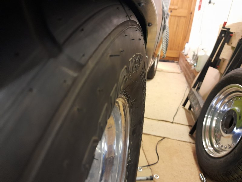

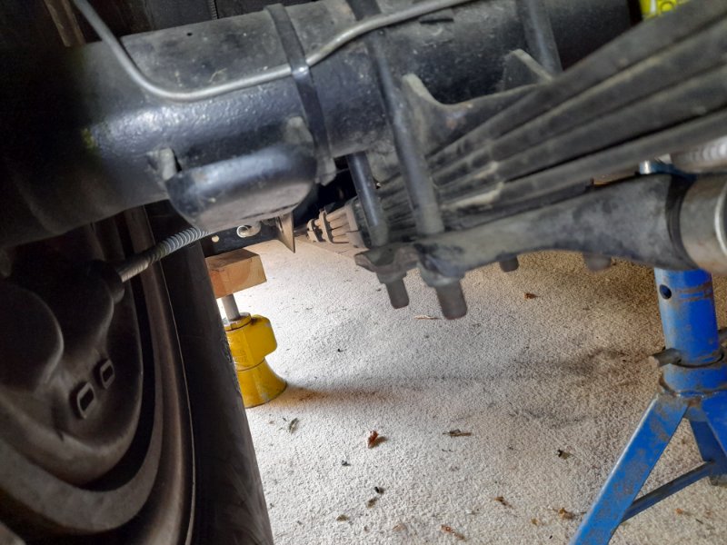

Some pics

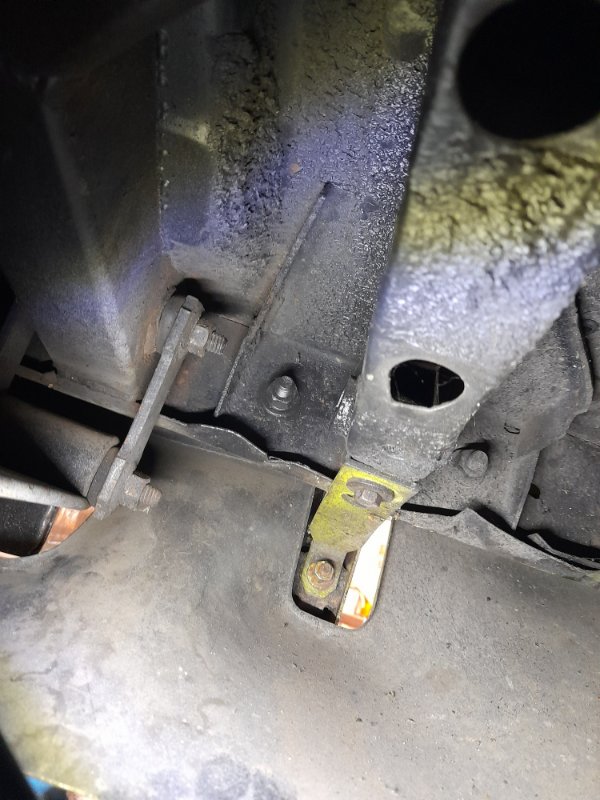

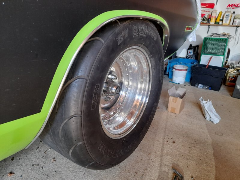

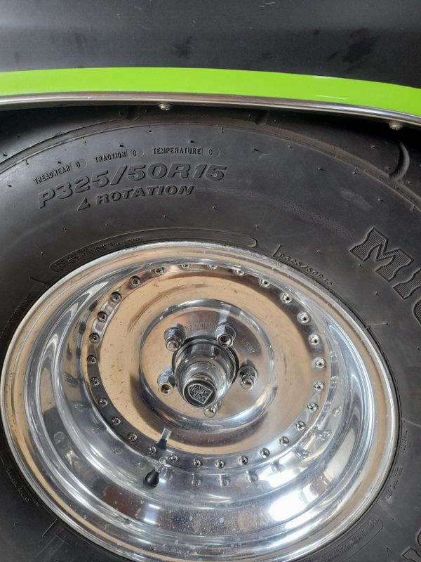

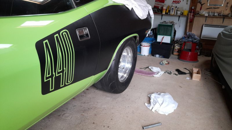

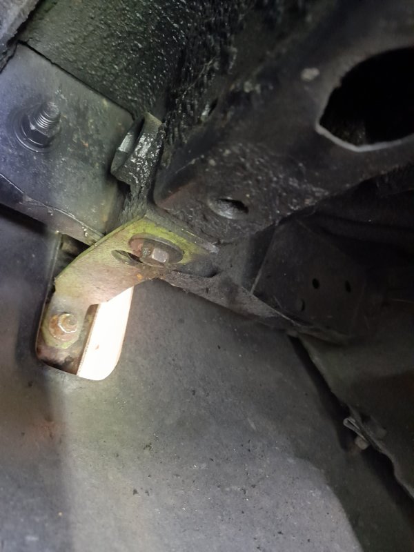

- this side is giving me the bigger headache
- cuda arch.jpg (119.76 KiB) Viewed 14506 times
- rear shackle relocated inboard
- rear shaclke.jpg (124.13 KiB) Viewed 14506 times
- this side fits by a fag paper , would probably touch on road
- cuda arch fit.jpg (162.7 KiB) Viewed 14506 times
- Another lowered off the the jack
- cuda arch fit 2.jpeg (151.2 KiB) Viewed 14506 times

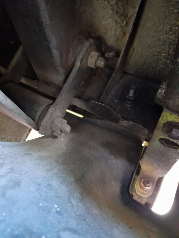

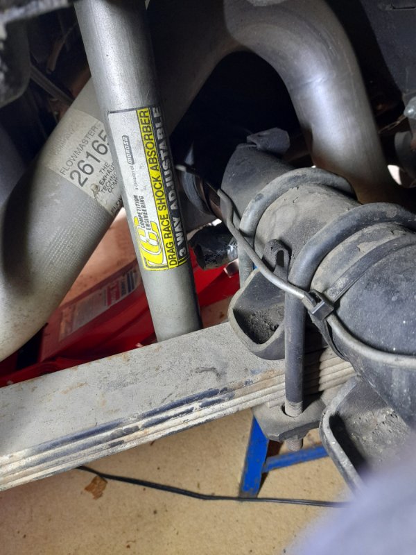

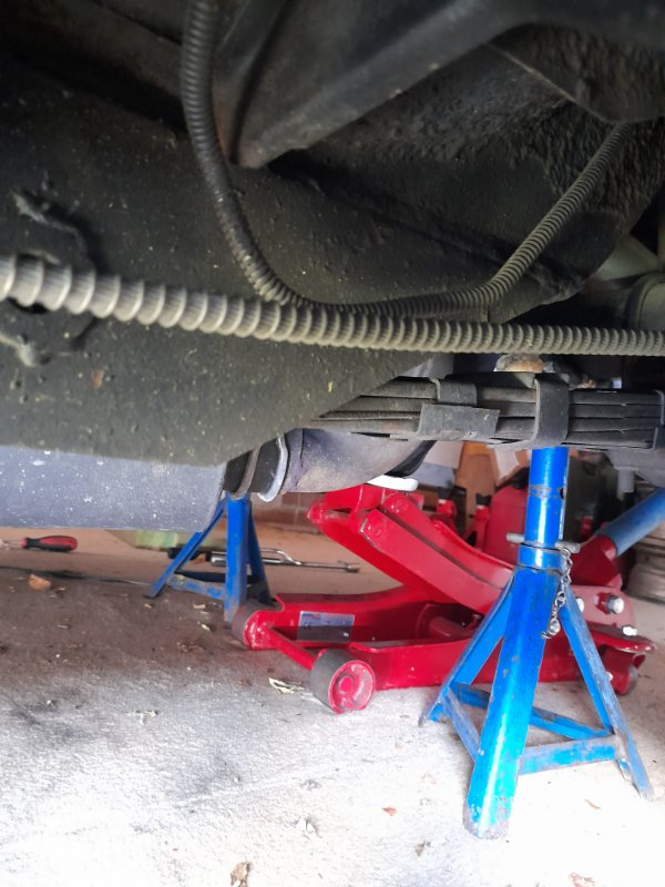

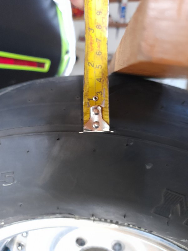

Ok so some more pictures to help my decision going forward.
Pete - thanks for the input and the kind offer to cannabalise your old springs. As mine are knackered I'm thinking the route forward is to replace with new as per Jon's suggestion. My goal with starting all this off with ally wheels was to reduce weight ( and rolling resistance re fronts). I don't know much about caltracs except a lot in NSS use them. So weight is in an additional issue in my decision making. The superstock springs look heavier (don't know) than what I have at the moment. Not sure about Caltracs - understand principle how they work but how heavy and if they will solve my tyre clearence.
So some pics ;
1. wheel that fits by a fag paper (would have to go up). I know it shows it in the air but this is the same as if it were off the jacks and on the floor - hence no suspension
2. Corresponding wheel showing mirrored measurement - 1 and half inch to top of tyre.
3. Springs inboarded - front
4.Existing leaf mount rear
5.Old leaf mount position
6. Drag shocks on car
