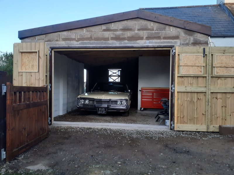

After what seems like years (it has been nearly 3 now I think about it) from the early planning stages, fighting through building and listed consent applications etc, my new home for the Dodge is nearly finished.
The basic structure and roof etc are in place and I am just waiting for roofing sheets to be delivered to make it watertight. I cant use it until its signed off but I did give it a test run before Christmas. I have limited space at the back of the house but it is perfect for my needs.

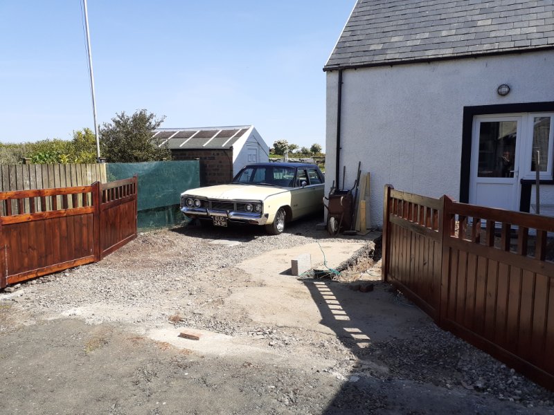

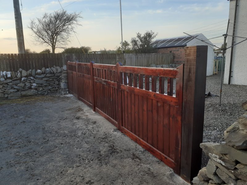

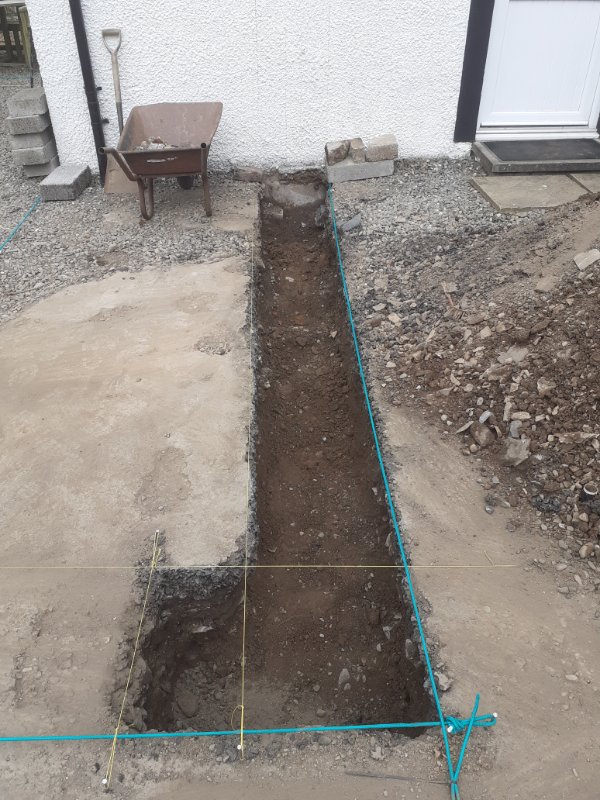

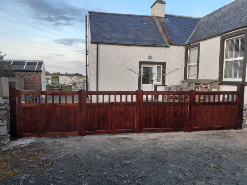

First job was to remove a stone wall at the rear of the house and build some gates to allow access. Also needed to check that the car would fit in the space I have available. I then made a start on digging the footings.
Tough going as the ground is very rocky. There was also a stone outbuilding that encroached into the floor space of the proposed garage so that had to be reduced in size .....

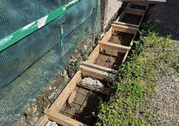

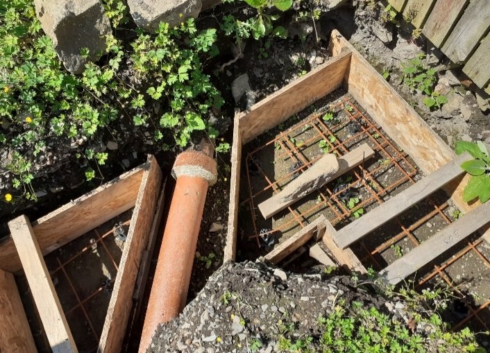

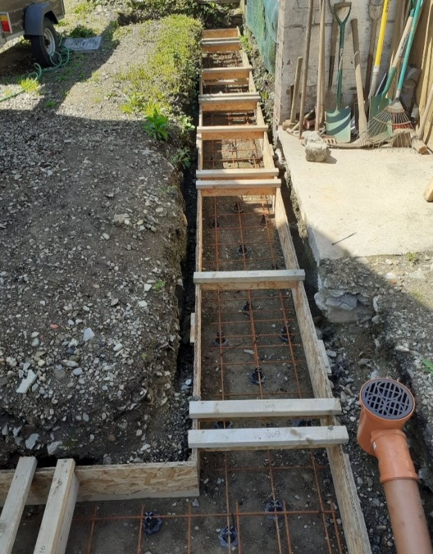

Posts: 7599
Re: My Dream Almost Complete At Last!!

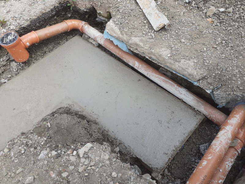

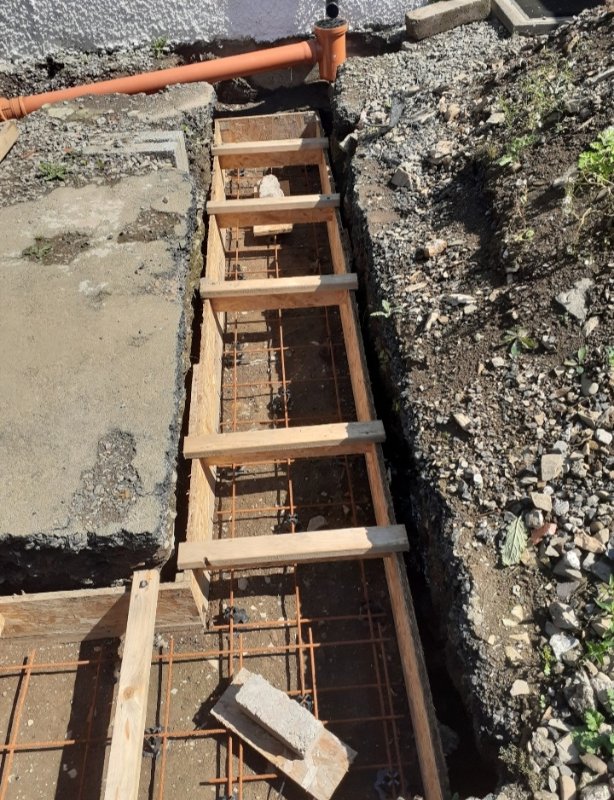

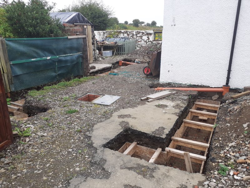

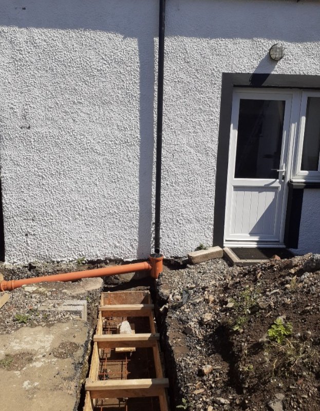

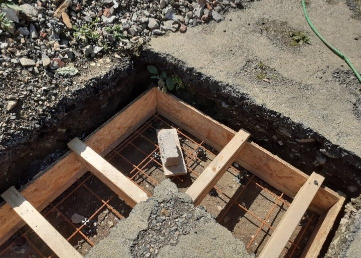

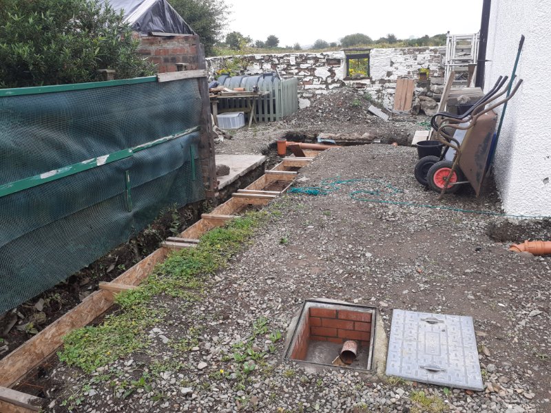

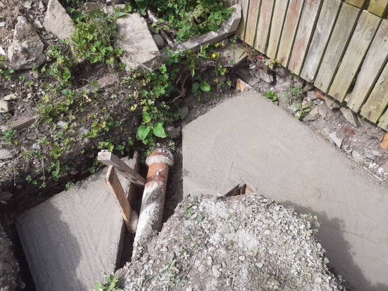

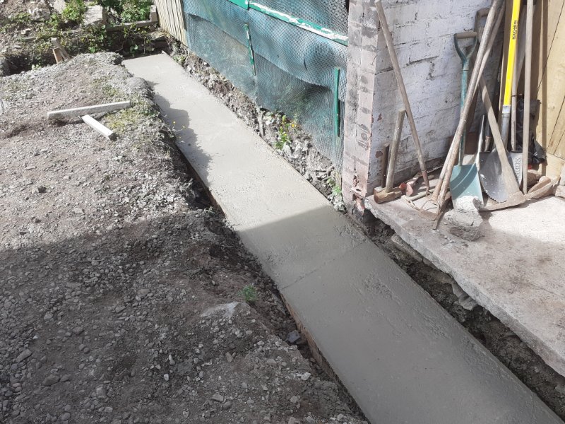

First big job was the footings. After I had reduced the stone shed by 50% to make room for the long wall, I dug them down and decided to shutter them so I can get perfect dimensions and depth. I know a builder (who isnt paying for the now extortionately piced ready mix concrete) would just pour them straight into the holes but this method worked better for me.

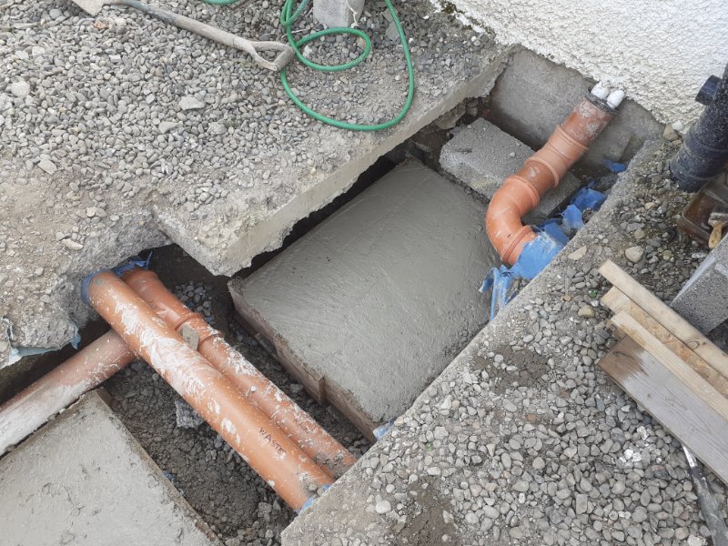

As the ground was so rocky, it was impossible to cut neat trenches and I think I would have doubled the concrete pour if I had just left rough trenches. Anyway, it allowed me to be meticulous with squaring stuff up and levels etc. Was quite complicated as all of my waste water and septic tank pipes run through this area and I dont have room to re route them. I had to bridge the pipes with lintels that I will show later. I definately over engineered that part and went bigger on the footings just to be safe.
At this stage, I also moved the roof gutter downpipe across and installed a new gully trap etc tied into the existing drains that go to a soakaway

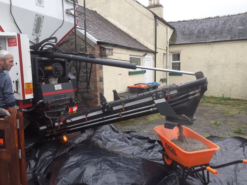

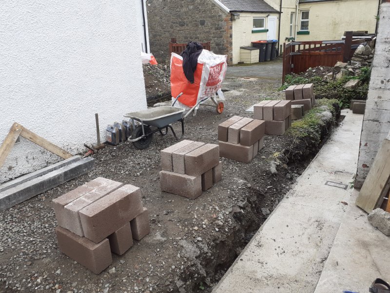

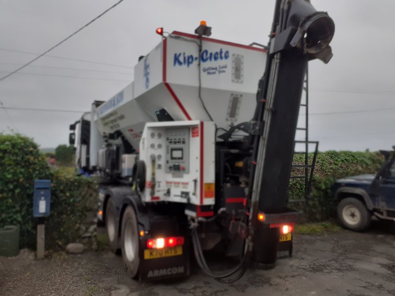

Next came the pouring of the footings.

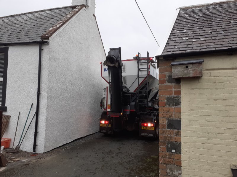

My house is an old School Hall and there is a shared driveway between it and my neighbours (the School House). I took a scale site plan to the guys up at the concrete suppliers and together with the boss and the driver we scratched our heads for about 15mins and decided we would just be able to get the mixer truck to the rear. It was very tight but I managed to get it all barrowed in in about an hour. It was then I realised that Im not a young man anymore \:D/

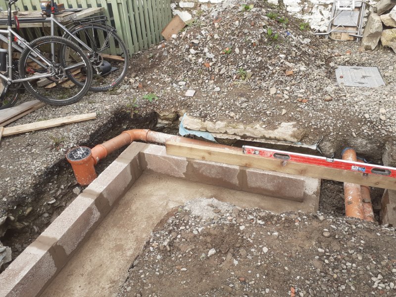

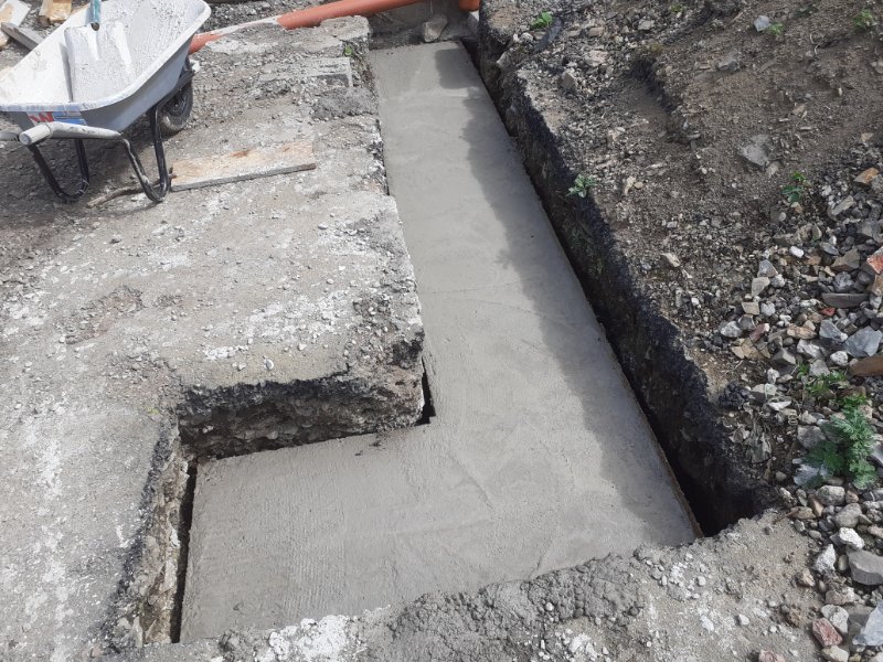

This was (on hindsight) my first minor mistake that I would do differently in future. I left a gap in the footings where the main door was to go and by the time I had extended them and made pads for the lintels over the septic tank pipe etc, I would have been as well just extending them across fully and getting both sides the same heigh would have been much easier. Its not an issue, just a learning point really as its all good in the end.

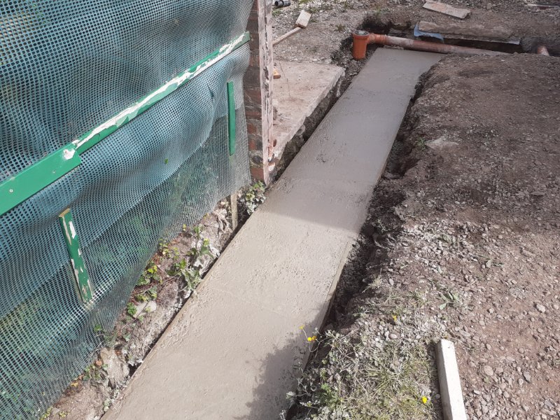

Posts: 7599
All in and levelled off......I slept well that night!!!! :thumbright:

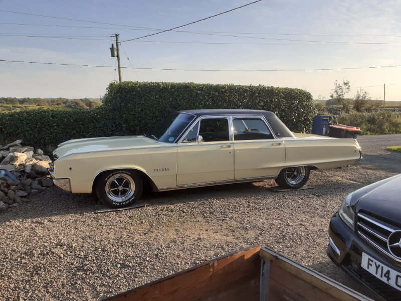

Since moving back to Scotland, my car has been on my drive under a good cover with storm straps etc to stop it blowing in the seemingly constant winds we get here. She hasnt suffered at all to be honest but it will be great to have her properly under cover.she was kept in a rented garage that was great in the Midlands.

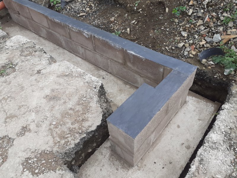

Posts: 7599

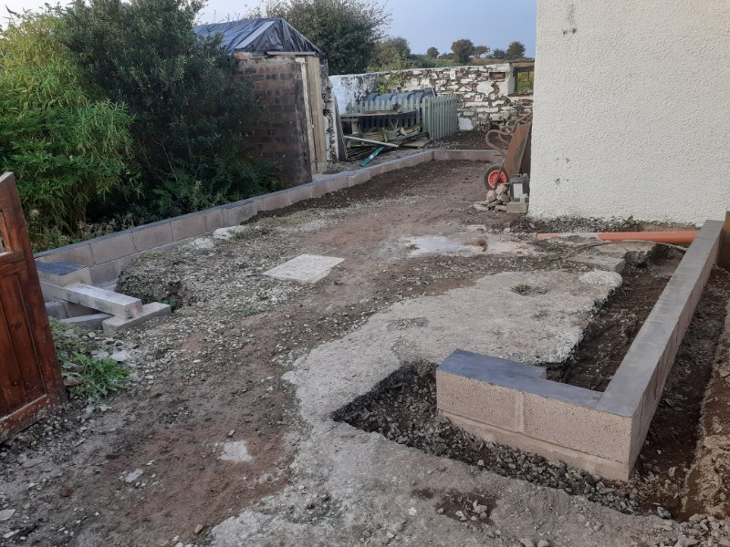

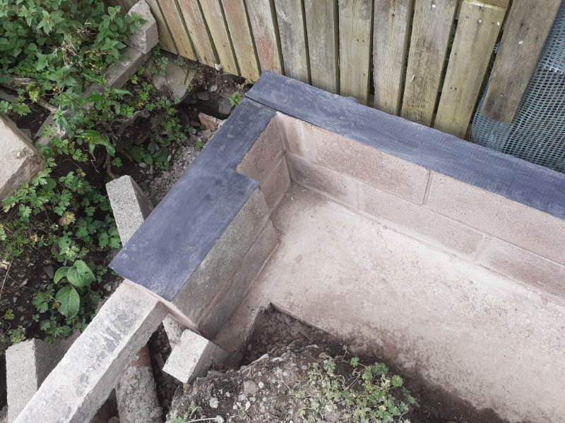

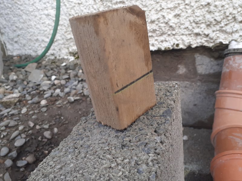

Next step was to get blocks laid square up to DPC. This proved difficult until I worked out that the newer extension on the back of my house that the garage is connected to, isnt square. The corner Im using is slightly over 90 degrees so a quick call to my pal in Canada who is a Civil Engineer confirmed that I need to square everything to the longest wall of the extension. It was easy doing the layout for the footings as there is some room for greater tolerances but when it came to laying the first row, I had to be very accurate. I used a laser level throughout the project which was a great piece of kit. It wasnt too expensive but the downside was it wasnt great in strong sunlight. You can just see the green line on the wooden block for getting the corners all level with eachother.
Now is the time I wish I had listened more at school. My cynical comment when I was in maths along the lines of 'pythagorus.....when will I ever use that!!!' Came back to haunt me. I eventually found a calculator online and used it to square everything up. It can become a bit obsessive and I settled eventually for a tolerance of about 5mm over all dimensions. Considering one of the long triangle sides was nearly 9m corner to corner, Im quite happy with that. It certainly paid off as I progressed as the blocks went down quite neatly etc.
