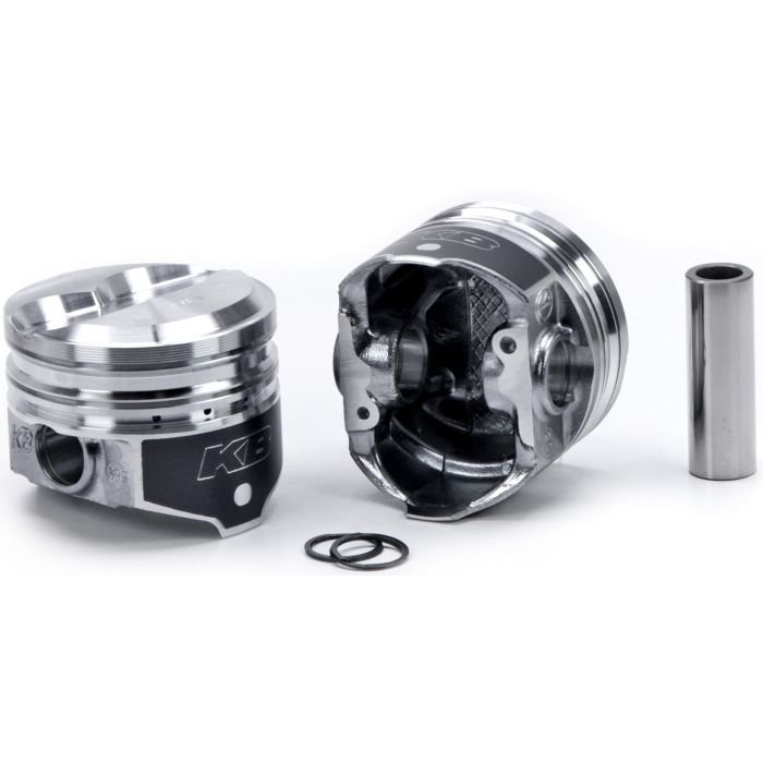

i've just bought a set of kb399 pistons for the 318. they're the domed top ones which will help regain some of the lost compression with the 360 head's bigger chambers. it should be quite 'sporty' i hope.
neil.

re the new pistons... i had 2 choices to regain the lost compression. 1) these domed pistons or 2) turbo the engine. the pistons are (even with the cost of a rebore) much cheaper and although the turbo choice would make more power, to be honest i don't need it.

I looked at them and the KB167 flat tops for my hemi 6. same bore different stroke 6x 720CC cylinders
ended up with a sealed power piston that was still hypereutectic but could be had from summit cheaper, basically a copy of the KB167
they ended up with a 40 thou dome the 399s were a risk with my semi hemi head, that big lump in the middle and my odd angled valves, the valve reliefs were in the wrong place...
A too tall flat top with the edge cut worked well. i built mine at 12.5:1
cammed to give effective/dynamic CR of about 9:1
no issues with detonation worked on a domed headed engine with minimal quench. potentially could have been right old a pinger if it was wedge or heart shaped chamber. my chambers are a bit like buckets
more like a poly 318 head than a la318 head

the pistons arrived yesterday and they're shiny, mmmmmm

the cleanest and shiniest they will ever look
