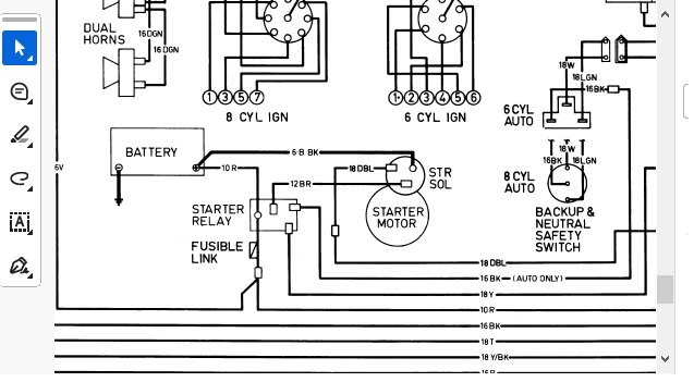

Halfords does a fat black starter lead in an appropriate length to run from battery to the stud on the solenoid with enough slack to avoid it being taught against any part of the exhaust. standard route or up to the the bulkhead tied down and back in a short run over to the starter
you will also have a small lead with a spade on it that runs from the starter solenoid to the coil end of the ballast resistor
check it has not pulled off and is shorting or is lying on the exhaust and partially shorted to a rusty header
this is your 12 volt ignition feed for starting. pumps 12 volts from the starter solenoid circuit direct to coil, only when the starter is running. short that out and weird stuff happens 1) little power to coil 2) you shorted out a part of the starter solenoid bang-on at the moment you need full power to turn the motor over...
i ran with mine disconnected and taped up for years... and now i run a 12 volt coil so its irrelevant
a 73 may differ probably got the 4 pin ballast and mine is a 2 pin, but worth a check....
starter has big lead on stud a switch lead that runs off the starter relay to trigger the solenoid and potentially a second connector for the ignition feed or that feed may be a T off the switch lead.
on mine it runs across and into the main loom section that runs up the inner wing from the lights, battery and windscreen washer. It connects in about 8 inches from the bulkhead. labelled 18DBL , i.e fat-ish Dark Blue , the box in its run, is the junction into the loom. The run from the starter to there is prone to exhaust damage so they made it easily replaceable.

- starter.jpg (43.83 KiB) Viewed 2217 times

Cheers Dave , I'll have to send back to auto electrician who re wired it. The ballast resistor was removed as part of the rewire. I've checked all the obvious cables to no change in how it still clicks... its almost like a dead battery but, changing the battery and putting a jump pack on has mad no difference.
Re: The Money Pit !!
ah ok
lack of ballast is not a problem, i presume you run 12 volt coil and won't need it or the 12 volt starter feed... less to go wrong..
so how is you starter motor wired?
do you have a starter relay and a stater motor? or do you have a non standard starter that has both relay and solenoid function in one unit?
if you use a starter like a standard chrysler starter or a later Chrysler/Denso one, without the relay on the inner wing in place
then the load put on the ignition switch by directly powering the starter solenoid will burn out the ignition switch in the START position.
early 60s A bodys used this set up as standard and had a unique, in chrysler terms, starter, with the relay action integrated into the starter along with the solenoid. Retrofitting a later starter to these 61 62 63 models needs you to add a relay in the later standard position. pretty sure most would have been updated. irrelevant to you mind...i was just chuntering on
there is also ,depending on starter design, a chance that the starter would run constantly, after all it is connected to the battery by a big fat cable. But that just depends on if the solenoid action in that starter also switches on power to the motor. If it does you can accidentally wire a car in a manner that doesn't involve the stater relay. Send power direct from the ignition switch to the spade on the starter solenoid it will work but eventually burn something out
the ignition switch and wiring would need to be robust enough.
so i guess what i'm saying is, has your auto electrician wired your car in a manner that assumes that the starter you have does not need a starter relay, when actually it does need one?

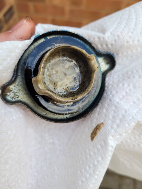

good news... I went through all the main wires again..... scratched my head a bit undone all the earth's cleaned them replaced connectors that I thought were ropey. Still nowt turning over.... scratched my head a bit more ....had a brew started looking over the positive side. Retightened all the cables going to the positive terminal ( is a strange one with multiple holes for cables that are locked into place with hex bolts ) anyway there was movement in the main cable , not much only a couple of turns. Low a behold it started... the Fitech isn't playing a 100% ball with the idle speed all over the shop....be one step forward.
Now after doing some checks I'm hoping I'm not getting a head gasket issue.....
- 20250604_172551.jpg (115.31 KiB) Viewed 2168 times
Its always the last place you look
if you don't know the history of the motor..... who is to say that someone didn't mix up the 710/0IL cap with the radiator cap !!!
if you know the history of the motor yeah..looks a bit wrong
if it was stored as a bare, hot tanked and machined block, oiled and wrapped or coated in grease, and then built up you might expect some evidence of oilyness on the coolant side, once the coolant washes it through it will float to the top.
if its just an old engine and someone did a cylinder head gasket job on it with it in the car id expect some coolant and oil contamination. the oil is easy changed but what ends up in the coolant side may be harder to be rid of...
i.e history
check before you commit to the work... could be innocuous or might not be... .
run it till the thermostat opens and you see movement in the radiator
drain it. (hot)
when cool again good flush through with the hose
fill it with water only, its cheap
run it and see if it comes back.
if it doesn't come back drain it and then fill it with your favorite coolant mix..
my last head gasket work was only done because i didn't check before i committed to the work...
I was too hasty
i.e history
drain it. (hot)
