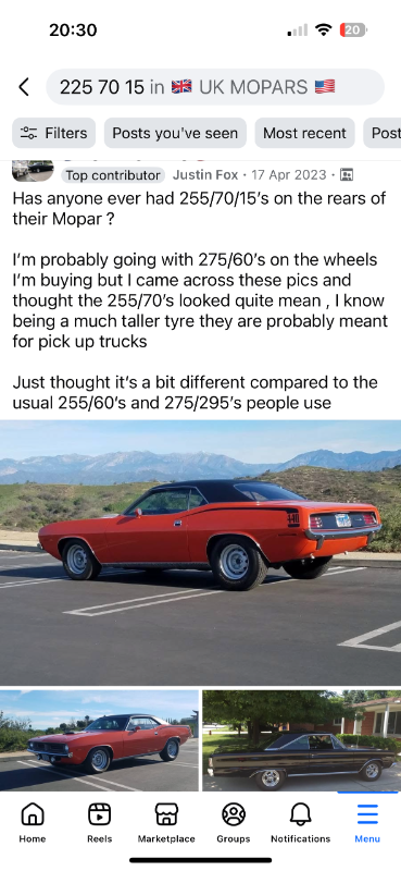

Here’s an ebody with 255/70/15…not my car.
- IMG_2969.png (292.36 KiB) Viewed 5031 times

Thanks for replies,much appreciated.Im up north near Lancaster but thanks for offer to mock up youre wheels.Yes refurb.arch springs ,there is a place in North West that does classics.The 255/70/15s pic is cool,it would create ground clearance for sure but looks too crazy high for me.
Ive measured front wheel arches -they a at 25" and look right,5" ground clearance to headers and plenty to sump and K-frame.Got 24" to rear wheel arches.Whats usual e body heights on these ?Ive adjusted/messed with exhaust mufflers and got 4" now to lowest point,so an inch of lift will sort it i think.A255/60/15 would sort it or do i risk a 275/60/15?i like 275s on challengers but dont want em rubbing.My new centrelines are 15x8 with -6et giving em 4 1/4" backspace.Thanks for youre help and input
