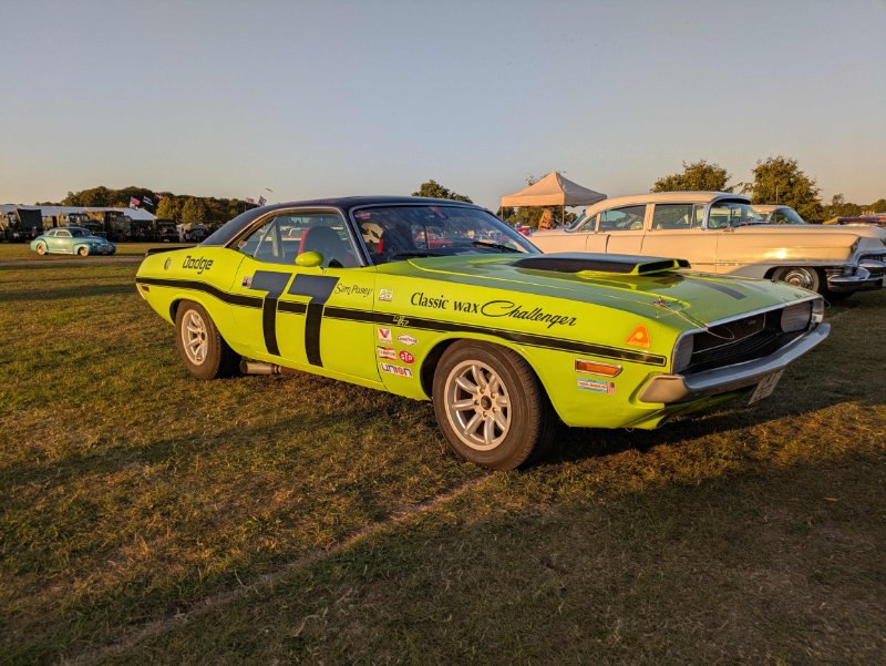

dodge challenger retrofestival.jpg (117.56 KiB) Viewed 15251 times
I've got 235/70/15s on the back of my 73 Challenger which is the closest I could get to the T/A size tyre as mine is a 70 TA tribute. I get a tiny bit of rubbing on the outer edge of the arch on the driver's side when loaded with camping gear for Le Mans and going round roundabouts, but otherwise its fine. I think my wheels are 15 x 8 Minator alloys (minilite lookalikes).
My exhausts are genuine T/A boxes with the forward facing side exits pipes, no ground clearance issues and I live in a town with 10 speed humps.

Thats a great tribute car,i want to make some t/a side pipes for mine,ive already got hood scoop
