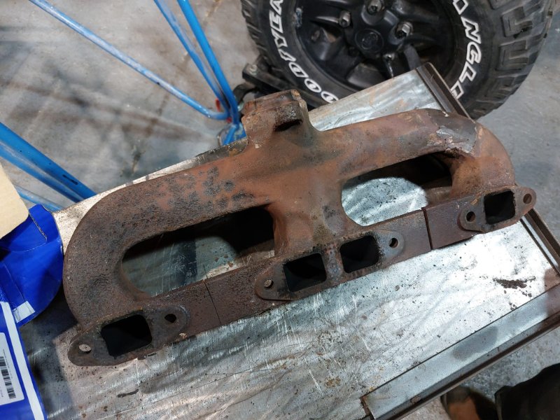

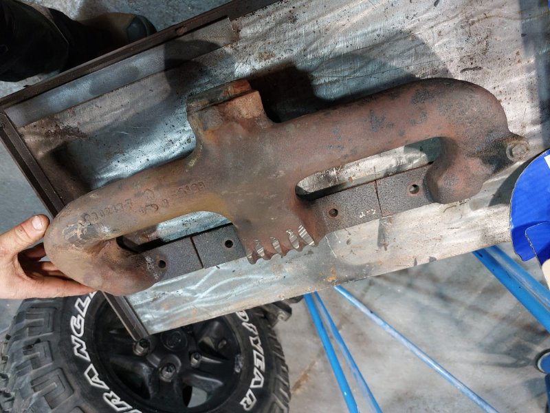

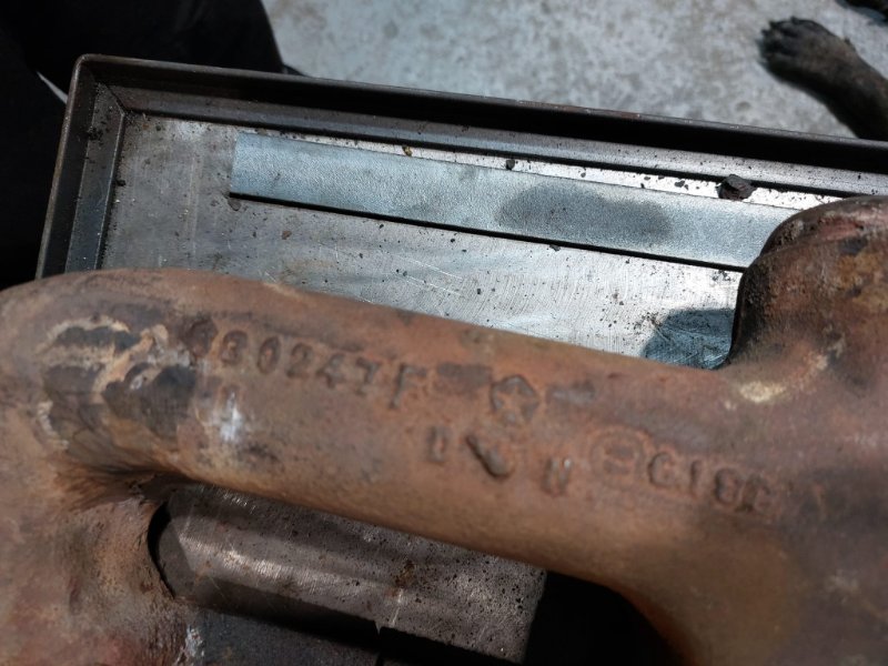

The l/h exhaust manifold is shot on my Dodge RV 440 - it's not the standard car item but a manifold specific to fit the B series van body with the engine under the cab. I've learned on an RV forum in the US that it's designed to handle heat differently from the car manifolds as these engines can get very hot hauling big RV bodies up mountains, etc. (The RV manifold collects gases a bit lower down, to keep heat away from the valve cover gaskets, as I understand it.)
I'm looking for the correct manifold (if anyone has got one to sell? see pics below for l/h side), but failing that I'm thinking about headers (regular/car 440 manifolds won't fit anyway). Should I be worried about the extra heat headers would generate as I'm here in the UK? It's obviously cooler than parts of the US, and I'm not going to be trucking over the Rockies.

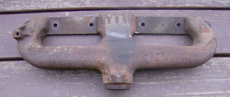

Here's what a good one should look like - part number is 3830247F

I doubt the heat from headers would be an issue, they are thinner than cast manifolds so don't retain as much heat anyway. Duncan (Cannonball) Watts might have manifolds he has ALOT of Mopar spares up in Crewe. He doesn't get on the forum very often now, so best to call him.

Those manifolds must be fairly rare, I’ve never come across a set. Headers every time, I don’t see heat being an issue but with a decent 2.5” exhaust system you will see an increase in torque and HP, certainly a bonus on an RV, you might even pick up a bit of mileage…

Thanks both - called Duncan but he doesn't have one. They are rare, but I thought someone might have salvaged an RV 440 for a car or truck project, and have the old manifolds kicking around. (That seems to be what happens to old RVs in the States, but perhaps people are less likely to scrap them over here.)
I'm thinking I might go with wrapped headers, but there's not much room in the engine bay so need to be careful sourcing the right ones.
