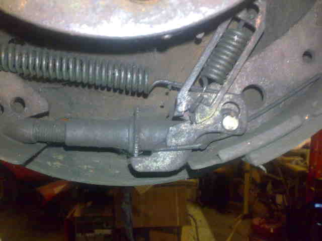

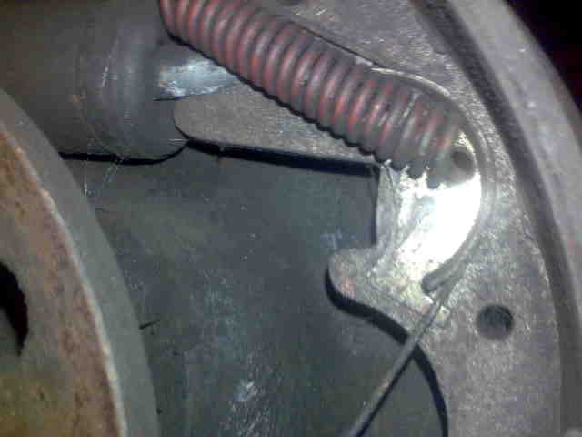

hi everyone took rear drums off today to see why the hand brake cables werent hooked up and found there were some bits missing just dont know what :help: :help: and does anyone have any i can buy off them :help: :thumbright:

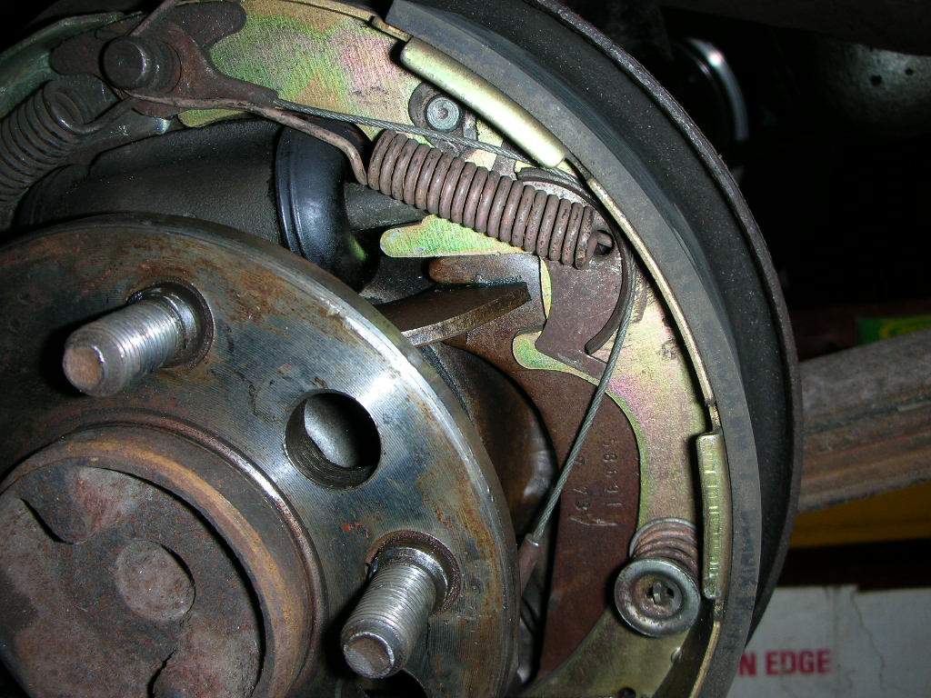

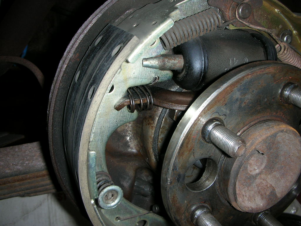

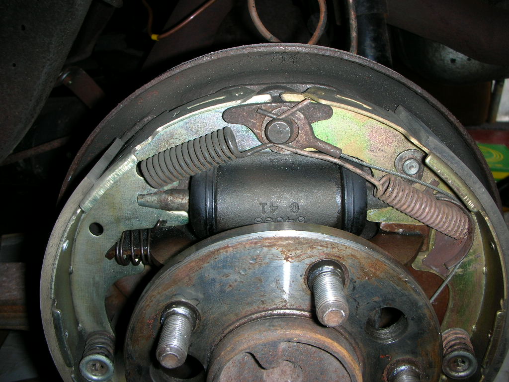

Here's some pictures of my rear brake set-up - note the thin spring at the bottom, mostly hidden by the half shaft flange, and the other thin spring which houses the park brake cable, attached to a park brake lever normally found behind the trailing shoe.
Hopefully the images will give you an idea of what is missing from yours.
Hope this helps!
