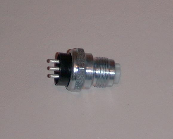

hi ia have a 67 gtx satallite and im fitting a b and m shifter to do way with the stick !! i got a new engine loom bay but it does not come with any wiring for nuetral safety switch how can i wire this up ????
There will be a safety switch in the trans, most likely has 3 prongs, early boxes had a single wire switch.
The 2 outside prongs are for reversing lights, the centre prong is for the neutral safety switch.
Your shifter should have a micro switch, which is activated in Neutral & park.
The centre prong wire should go to the connector on the bulkhead/firewall, which feeds to the 'Start' position on the ignition key. When turning the ignition key the switch feeds power to this terminal & engages the starter relay.

- Trans Safety Swirch.jpg (19.09 KiB) Viewed 194 times
