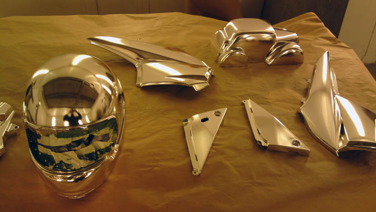

Guy wrote:Check out the chrome and heat paint here www.alsacorp.com some real nice stuff
'Chrome' powder coating youtube video from Guy's alsacorp.com link....

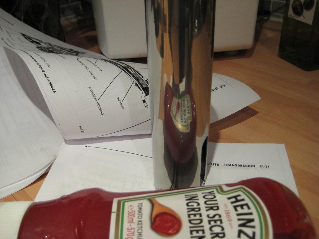

Here is the 'chrome' powder coat sample made today.
This has not got a clear coat over it. with a clear coat it will be less reflective but will retain it's properties for much longer than if it does not get a clear coat.
This picture is very flattering to its colour and reflection.
Other light conditions and it just looks grey/silver.
Nothing like the real thing but a whole lot cheaper!
