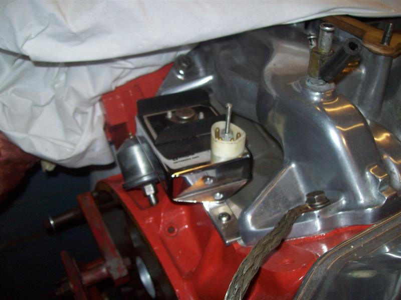

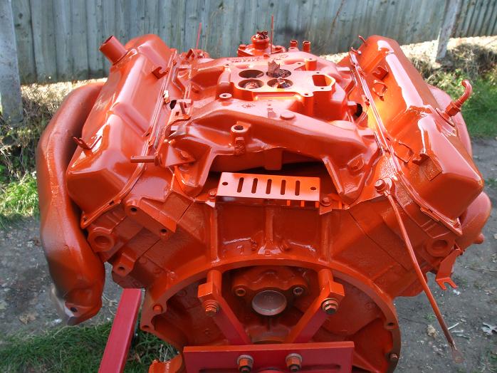

Below is a pic of where I'm thinking of putting my orange box, It will be on brackets about 1/2 inch high and will have plastic washer to try and stop the heat transferring to it, Is this a good or bad place to put it, has anyone else put theirs there.

Posts: 7502
challenger wrote:on the firewall del, its still gona get hot on the top of the motor, heres where i got mine
I can't put it on the firewall, It's an air con car so i don't have the room, 3 sets of pipes come out the fire wall, looks like it might be the inner wing again.

seen a lot over on the US sites mounted on the back of the intake , but as Dave says need to be cooler place as possible , same really for the coil , ( been meaning to move mine !! will do sometime) , this is where i mounted my orange box , make sure it is grounded well also , like the voltage regulator , i run a extra ground wire to each , cause i'm nutts like that :?
this is the only picture i have on the computer , if anyone wants closer picture , let me know

I put my MSD there on the 'Bird :thumbright:
I used to have my Jacobs unit there. ;)

Have mine there too :thumbright:
Was concerned at first in case it wasnt that water tight and secondly, if it was ok mounted vertically :roll:
Need`nt have worried though, all is good :)
Mine was mounted far top left of pipes good flat area,also an aircon car.
Not much room on inner wing with aircon unit and hoses.I mounted the coil there,still havent made a proper bracket .Dont like it on engine and makes wiring neater ,IMO.
No photos im afraid.
Del, Paul Davey (Paul500) mounted his on the back of the inlet manifold like that, but he had a super dooper bracket made up and some heat sync attatchment because of the heat (obviously). He was adamant it shouldnt be seen trying to retain some originality buit had to do a fair bit of jiggery pokery to make sure it didnt get cooked.
