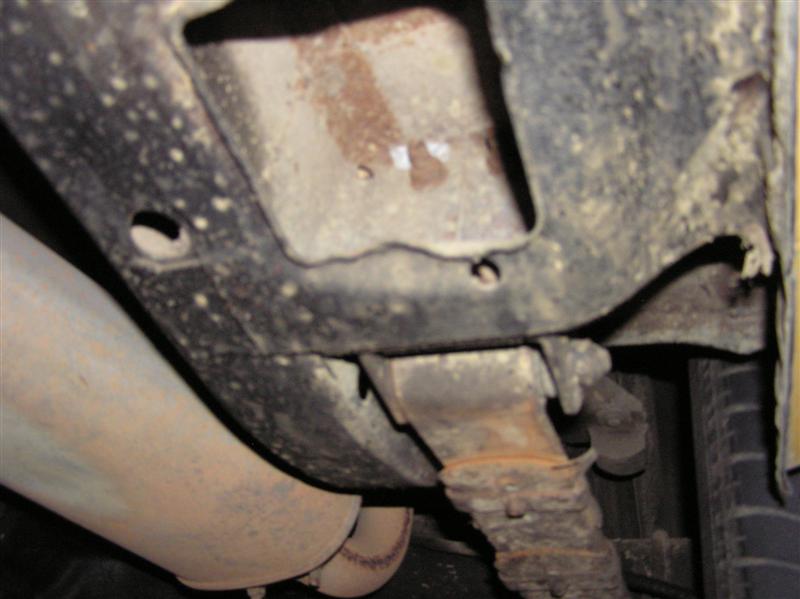

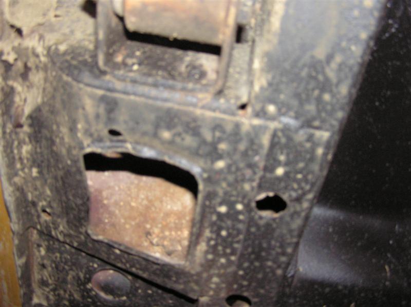

i hope this helps
Have a look here, there are photo's that should answer your questions, I know it's E body but the front hanger mounts are pretty much the same on all 60's and '70's Mopars.
http://www.moparmusclemagazine.com/tech ... index.html

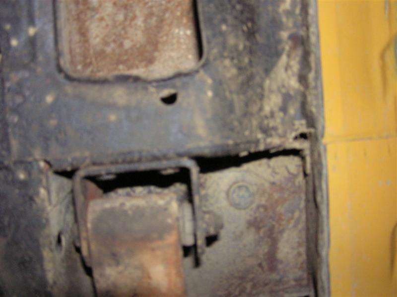

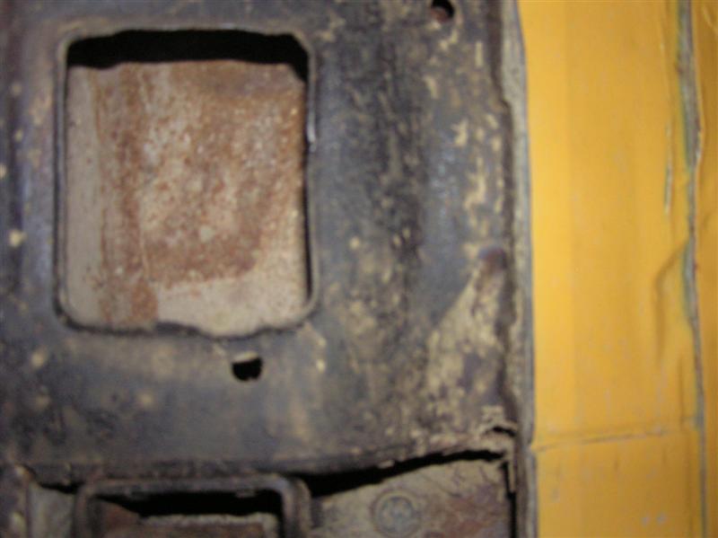

Posts: 9561
is this it?
this reminds me
waxoyle time again

Dave999 that is the square hole, so we Aussie owners have beefed up mounts as standard :thumbright:
Thanks for the advice and help on this, I was about to weld a plate on like the last one but Blue's toruqe box explanation emans I dug a little further a decided to try and do the job properly rather than cover it up again like it was by the last owner.

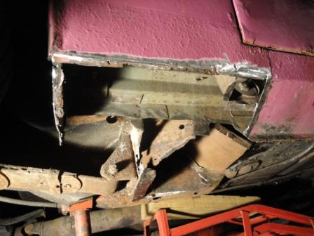

bit more rust.JPG (36.07 KiB) Viewed 837 times

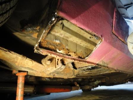

Got stuck in and have put some new metal in...
1030pm tonight.JPG (36.85 KiB) Viewed 834 times
