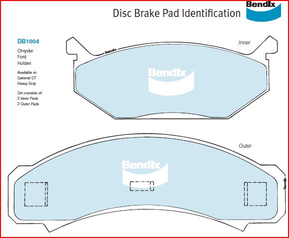

Am looking for a set of the pads in the below diagram, they fit VJ & VK Aussie Valiant Girlock callipers.
Looks like someone swapped my original VG Girlock callipers for later model ones at some point.
These are definitely what I need.
The diagram is from am Aussie supplier and I have been unable to find similar publications for the UK market to see if the same pad is available here before I get a set sent from oz.
Can anyone help please?
Thanks

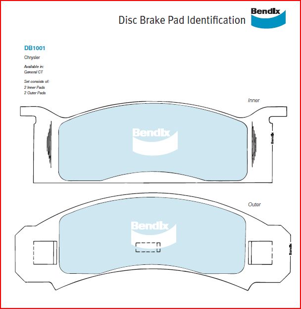

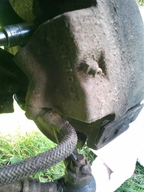

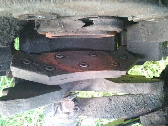

Hi Dave.
About 99% sure it's going to be VJ/VK. They look to be the same calliper as the HJ/HX Holdens that received cast iron Girlocks.
VG/VH pads should be the ones in the below diagram.
VG/VH callipers have very obvious slider pins, mine don't.
From what Terry told me a few weeks ago and I subsequently read, the slider pin on the earlier callipers were prone to breaking.

http://bendix.com.my/pdf/Vehicle%20Appl ... 20Data.pdf
DB1004 fits 73/77 VJ,CJ,VK,CK,CL,73/76 XB Falcon 76/77 Holden HQ/HJ all fitted with Girlock calipers.
DB1001 fits 70/73 VH,CH,VG,with KH caliper.

FERODO DISC BRAKE PADS VALIANT, FALCON,HOLDEN,DB1004
Manufacturer Model Year Model Variant Front
Results for part DB1004 Manufacturer Model Year Model Variant Front Rear Park
Chrysler Valiant 1973 - 1977 VJ, CJ, VK, CK,CL all models Girlock Caliper DB1004
Chrysler Valiant 1975 - 1977 VK,CK,CL,CM 10in Drum Brake DB1004
Holden Holden 1976 - 1977 HX Girlock (Cast Iron Caliper) DB1004
Holden Holden 1974 - 1976 HQ, HJ (Girlock Front Disc) DB1004
Ford Falcon 1973 - 1976 XB Falcon GT Girlock Front Disc DB1004
Ford Falcon 1976 - 1979 XC Falcon Girlock Caliper DB1004
Ford Falcon 1973 - 1976 XB Falcon (Exc GT) Girlock Front Disc DB1004
