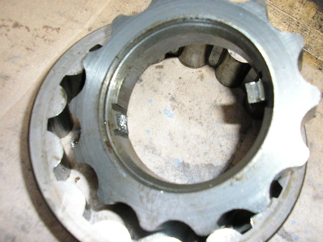

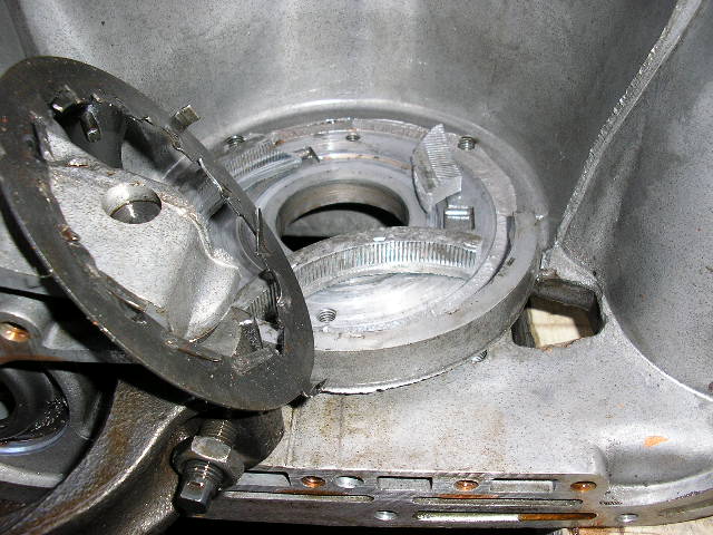

Hi Moparfolks,
This is what a sprag failure can do to your 727 trans!!! :shock:
Oops spragtastic.JPG (65.57 KiB) Viewed 870 times
Sprag eats 727 case.JPG (78.13 KiB) Viewed 870 times
Sprag-case failure 727.JPG (67.4 KiB) Viewed 870 times

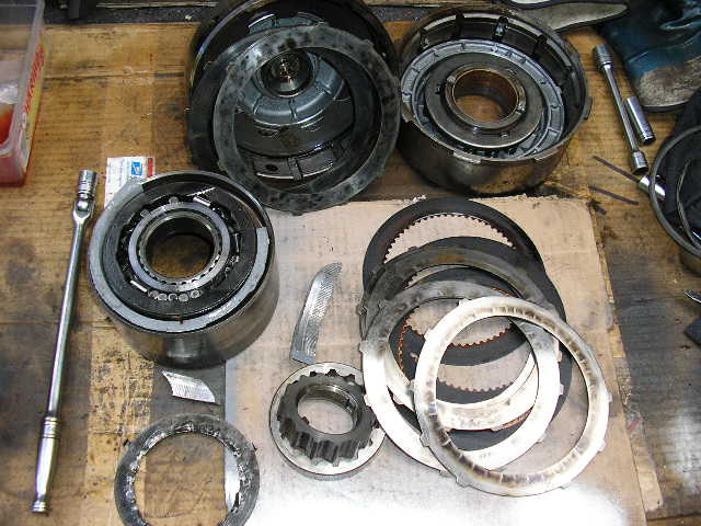

Then if you drive with a broken sprag this happens!!! :help:
727 pump failure.JPG (67.08 KiB) Viewed 864 times
Wobbly clutch plates.JPG (77.31 KiB) Viewed 864 times
Burnt clutch packs.JPG (66.17 KiB) Viewed 864 times
It still drove didn't it?I had the same thing happen but it got me home :roll:
Hi Drew,
Yep still drives in first gear, BUT, it wrecks the whole trans!!! :roll:
Not one piece can be saved or reused except the tailshaft LOL!

Bacca I remember back in the early 1980s Steve Rawlings Road Runner had an axle failure. I remember say that the box might need a rebuild because of the sprag might fail. Didn't rebuild the box next time he ran it, it blew the box apart had a hole it the floor bits of box went through the bulk head lucky he didn't loose a part of his leg. Listen to Bacca be warned.

If one fails you can get home if you keep the speed low and the gears high (the front drum will be rotating at twice engine rpm) but it is sure not advisable as there will be swarf making it's way into every nook and cranny.
So drive only if you are desperate to get somewhere safe.
