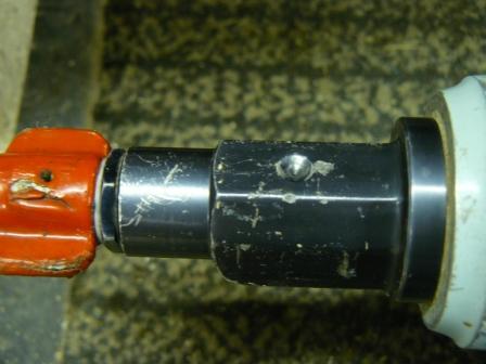

-The pipe fitting looks to be some sort of clamp-on arrangement- there's an O-ring around the opening but no thread. There's a machined dimple on the rear of the neck which is clearly for a locating screw. Is this sort of fitting still available?

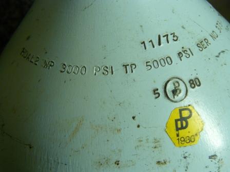

-It's a Luxfer bottle, stamped and stickered 1980. Will i need to get it tested or will they be happy to fill it as-is?
-Do the various stamps mean anything i should know about?

The stamps...
2011 Nov. N2O bottle 07.JPG (35.86 KiB) Viewed 852 times
2011 Nov. N2O bottle 06.JPG (22.62 KiB) Viewed 852 times
2011 Nov. N2O bottle 05.JPG (23.48 KiB) Viewed 852 times

Posts: 9563
no idea about the bottle stampings
i'd suggest that you would want to rid yourself of that valve and get a nice new one put on.....
but only after having it tested....otherwise waste of cash
1) it will have current safety disk for explosion protection
2) you will also find out if that bottle has a syphon tube which will dictate how it can be used
3) will have a guage port so you can put on a guage to see what pressure is contained within
local fire extinguisher place can tell you all about valves safety and how to get bottle checked.
find out from local dentist or hospital where they get their laughing gas from......
local supplier is always handy...and will of course have to carry spares to repair valves on suspect returned bottles (mainly from the NHS and universities)
approx
15 litre tank
1 cubic foot...
how much you can store in there is based on what pressure the tank can take and i'd rather not hazzard a guess.
it would be rated orginally to take a specifc volume of gas at a specific temperature, probably at room temperature (21*c) with some headroom to take into account hot hot conditions
