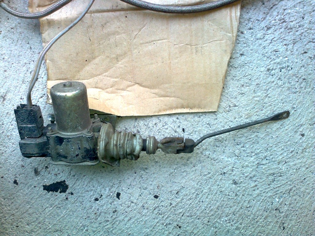

MYSTERY OBJECT... any ideas on the solenoidy-plungery-thing?
Mystery Nitrous device.jpg (244.01 KiB) Viewed 446 times
Nitrous goodies.jpg (228.41 KiB) Viewed 446 times

Do you know what my mystery object is Les?

only thing I can think of it being is a very old form of actuator to bring the N20 in at WOT mounted in front of the carb?....but all you need is a small microswitch as you know..
Hi Paul, this looks like a very old bit of kit, your mystery object, I think, is an early type FOT switch arrangement.
As you probably know most systems only work when your foot is planted at the "full open throttle" position, I figure it would have been attached to the throttle in the car and set to operate the system.
On the more up to date systems a micro switch attached to the throttle linkage is used.

I thought it must be some sort of throttle switch but like you say, right out of the ark!
The bottle's dated 1986 so i'm sure the whole kit dates from around then.
I thought it was a twin plate at first but- there's only one set of pipes, one injector plate is a spare.
