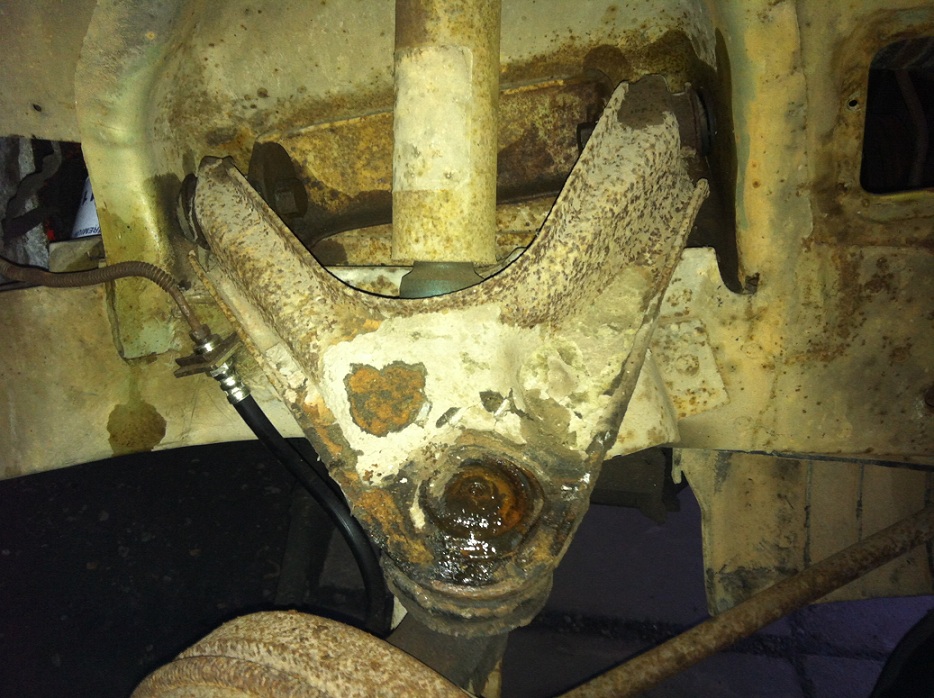

Well, I was right, it WAS an absolute arse to get out!
I bought a nice new breaker bar too but it just didn't want to play at all, even with a scaffold pole on the end of it
It was in so tight it was as if it was welded in there. This 1 just didn't want to budge at all.
Heat, heat, heat, heat and more heat. Nope. Nothing. 3 hours later I got Bananarama! off with it, so out came the grinder.
It soon budged then
Well, it still took another 1/2 hour to get it out, but I got there
Upper arm all cleaned up, it was time to install the bushes.
The good thing about doing the opposite side a week before was that this time I knew to removed the outer sleeves of the old bushes from the arm BEFORE attempting to put the new bushes in
( shh Jerry
Once the bushes were installed, the new ball joint went in a treat and a coat of paint was applied.

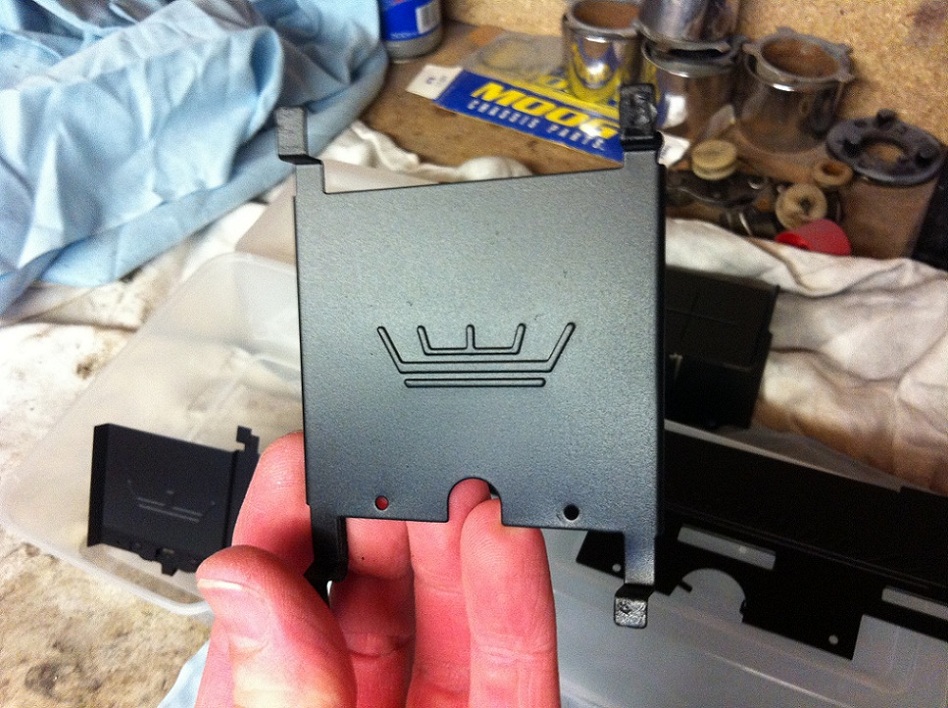

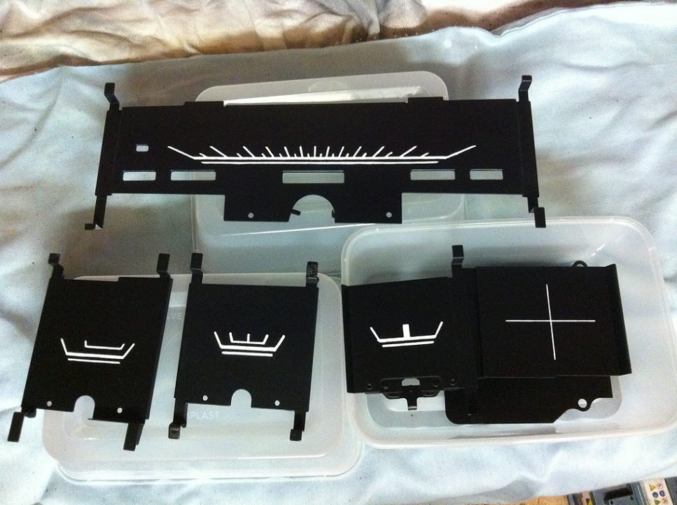

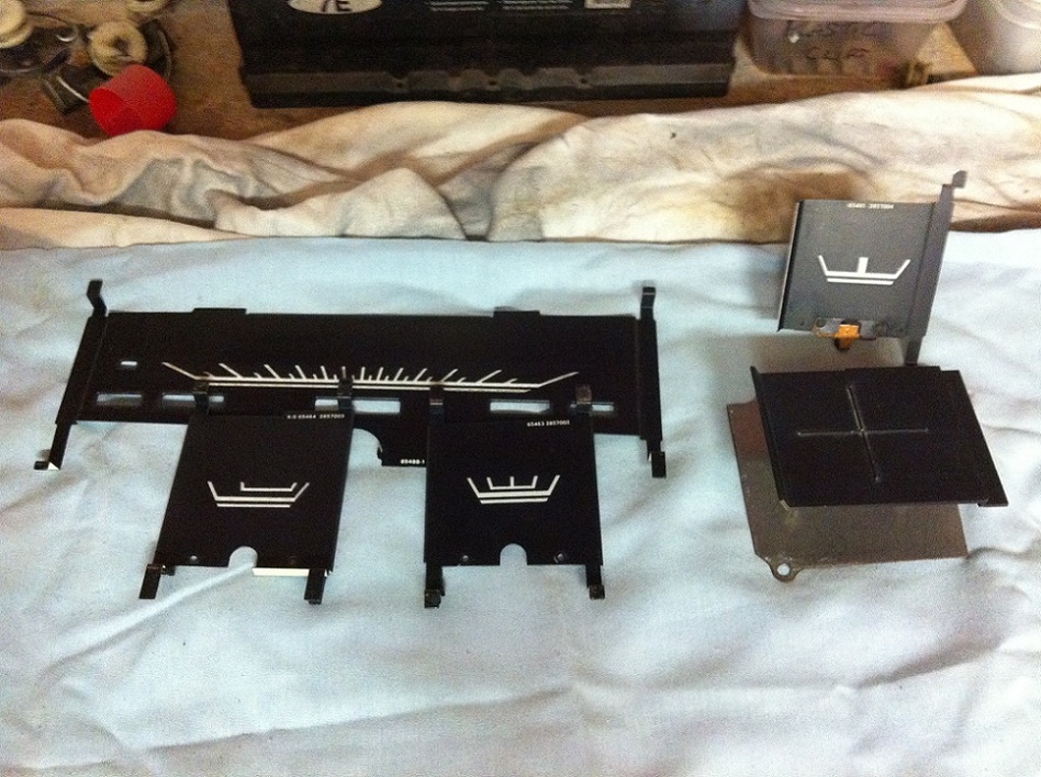

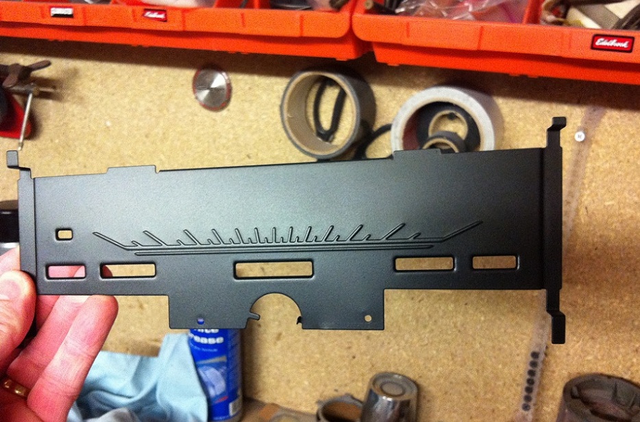

Although I had already cleaned up the dash on the '68, I wasn't too happy with the gauge faces.
The white paint just looked grubby against the black faces, and there were small areas of the faces that I didn't like either
Very small bits of surface rust were starting to come through.
Unfortunately at the time, I didn't have enough paint or equipment to do what I wanted to do, so back in Feb I decided to buy what I needed, strip the dash out again and have a go at painting them up properly.......
Came out real nice

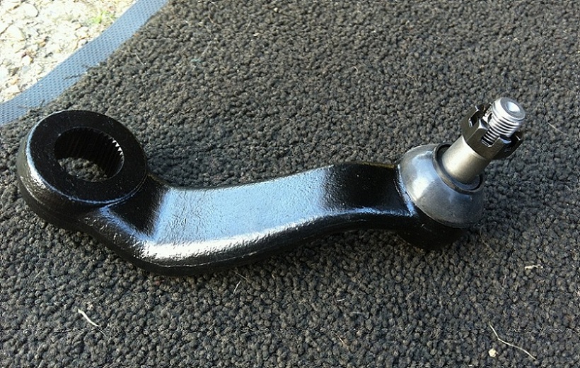

Also fitted a new Pitman arm to the steering the other weekend, as there was abit of wandering going on
New oil sender too as that gave up the ghost for some reason or another
(1- 1/16 socket incase you were wondering
Beats using mole grips anyway

Gauge faces look excellent
How did you do the white on the black, mask up & paint or free hand with a brush ?
- autofetish
- Posts: 5599
Thankyoumopar_mark wrote:Gauge faces look excellent![]()
mopar_mark wrote:How did you do the white on the black, mask up & paint or free hand with a brush ?
Free hand with a paint pen .....
Different size nibs. They work a treat
They're like a miniature rattle can. Shake like hell sending the little ball mad inside
Keep some kitchen roll handy to wipe away excess from nib before application, then it's just like drawing
I tried ages ago with a brush (like a touch up stick).
Result was a bag of Bananarama!!
